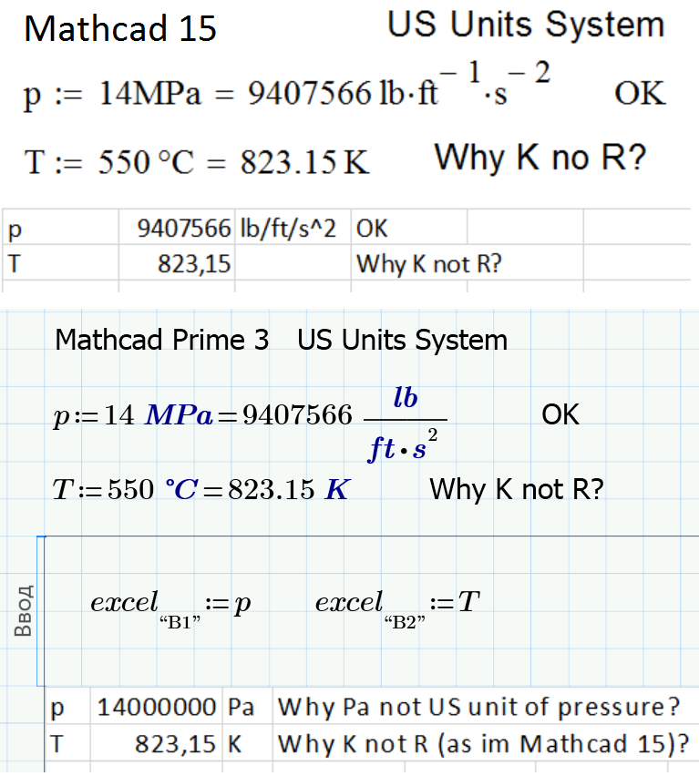

Is there a short name ofthe base US pressure units?

The base temperature unit in the US system *is* Rankine. Mathcad gets it wrong.
However, I and Mathcad are both unit-bilingual, so this Mathcad error is mearly an annoyance. BTW, I was just looking at the definition of the ICAO Standard Atmosphere (for something totally unrelated to this conversation and even my own work) and found that the standard lapse rate used to calculate temperatues in the lower atmosphere is officially defined as "-1.98°C per 1000 feet." Yep, mixed unit systems…at least according to the three semingly knowledgeable websites I checked.

R (Rankine) is in Mathcad 15.
The pressure unit I use most often is psi (pounds-force per square inch). I am a civil engineer and psi is the unit I use in water system modeling and design and for other hydraulic applications. When applicable, it is sometimes expressed as psia (psi absolute) and psig (psi gauge). Zero on the psig scale is one atmosphere.
Here are some common pressure units used in the US which are also built into Mathcad Prime 3.0. I didn't check Mathcad 15.
atm = atmosphere. 1 atm = 14.7 psi (±). Thus x psig + 1 atm = (x + 14.7) psia.

Aug 20, 2014 5:23 AM UTC
Thanks, Fred!
But the questions were:
Why we have not R with temperature when we have US Units system...
23-Emerald I
Aug 20, 2014 11:40 AM UTC
Because PTC/Mathcad is still hoping that the USA will convert to metric?
