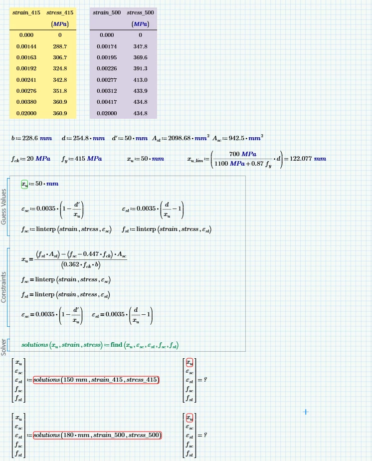

Unit_Error while solving equations using solve_block.
I am getting error for unit compatibility while solving equations using solve_block.
Please guide me to make correction.

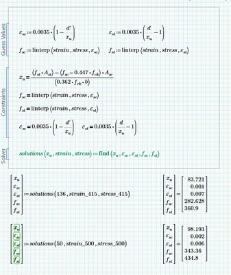

In the attached (unit-less) file I changed all values to the same numeric values which are used in the sheets with units.
As you can see, the calculations fail now!

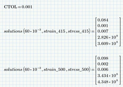

You would have to set the system variable CTOL (convergence tolerance) to a rather large value like 10^-1 (default is 10^-3) to make the solve block work again and this at the cost of precision.
OR you let CTOL at its default value and provide other/better guess values.
I found that a guess value of 60*10^-3 makes for both sets the calculation work OK
Using other guesses was already the 'solution' in the sheet with the units.
In the new sheet here I found that 60*10^-3 and also 80*10^-3 are good guesses, but the second calculation (strain_500) fails with a guess of 70*10^-3. So there is a high sensibility concerning the guesses...
The error message I get is not about a unit mismatch! Its about Prime not being able to find a solution! ???

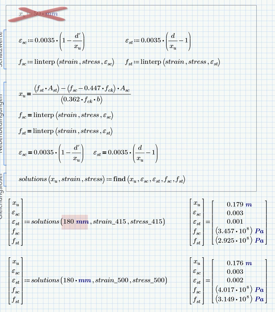

For some reason you are providing the guess value for x.u via the first function argument. If you want to do so, you must delete the hard coded assignment of the guess value (x.u := 50 mm).
Now the call with strain_500 returns a result, the first one with strain_415 still doesn't. Reason seems to be that your solve block calculation is very sensible with respect to the guess value. Changing the guess to 180 mm makes the first call work as well.
MSRAZA10-MarbleAuthor
Nov 20, 2024 3:00 PM UTC
I appreciate all that you have done for me.
But when working without units, it is working perfectly without any error.
we can verify by root function, which was shared by you.
Kindly find the attached file.
Thank you.

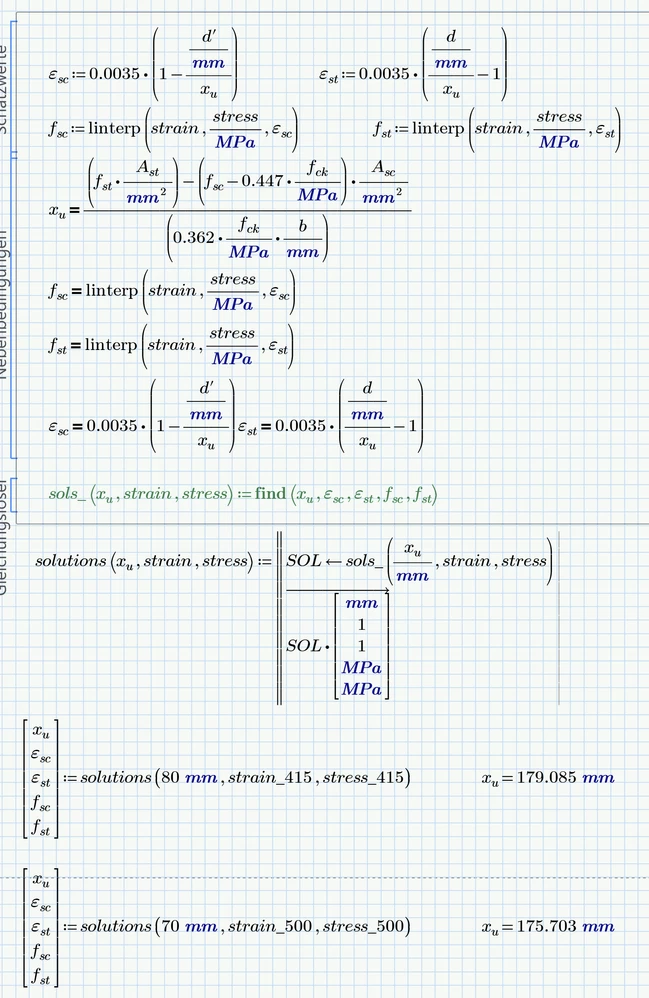

Nov 20, 2024 6:44 PM UTC
Thinking of a different setup as Luc has shown sure is preferable, but in cases where this is not possible and you experience similar problems, you still can use units in your worksheet but strip the units for the solve block and add them again afterwards.
Its quite cumbersome and ugly looking and not recommended, but can be done if really necessary 😉
Here is one way to do it using the example of your solve block.
Prime 10 sheet attached
