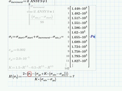

Thanks in advance for any input.  I am somewhat new to Mathcad Prime.  I have generated a range variable sigma_t. when i use this in an equation H(sigma_t):= it does not compute and gives the "this variable is undefined" error.  I cannot for the life of me figure out what the issue is and what i can do to fix this.  assistance would be greatly appreciated!

You are defining a function H which is dependent on an independent variable sigma.t (which at the time of definition has nothing to do with the range variable of the same name!).
You cannot evaluate (the equal sign after the definition) a function definition.
So delete the = at the end and you have a valid function definition.
There is also no need to define sigma.t in front of that definition.

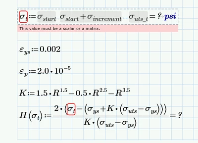

Now for the range variable and changing default unit to psi not working. This may called a bug in Prime.
You can define the range and evaluate it in a second region where you can change the unit:

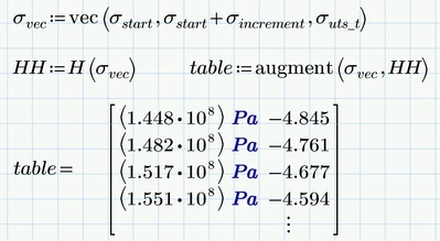

For anything else you should use vectors. Starting with Prime 11 a vector can easily be created using the new "vec" function.

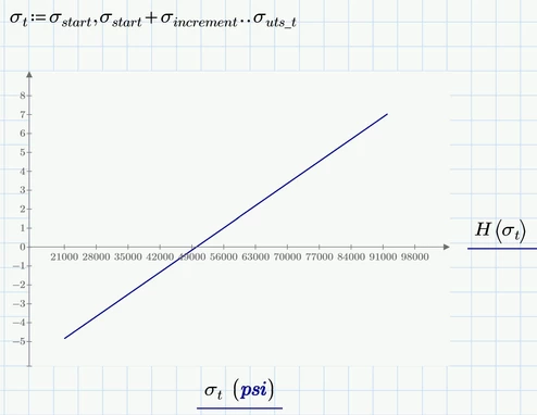

This said, you sure can use your range as the abscissa values when you plot the graph of your function H (which is a simple linear function):

So to create a table of values you should use vectors:

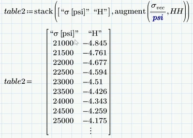

Here you see a severe limitation of Prime - we cannot change the units inside of a matrix from Pa to psi.
One way around this may be to divide the vector by the desired unit, creating dimensionless values and maybe adding a header line which names the units we see:

Also if i change units "Pa" to "psi" for sigma_t it then says "this value must be a scalar or a matrix".
i feel like it is related but cant figure out what i should do to resolve. thanks
