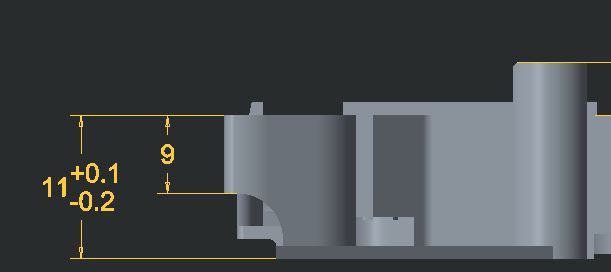

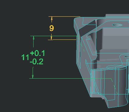

    Is it possible to add a driving dimension (technically, considered an AE) to an AF, in order to and have better control of which surfaces are included in that dimension, and are highlighted when that dimension is selected?
    The backstory......

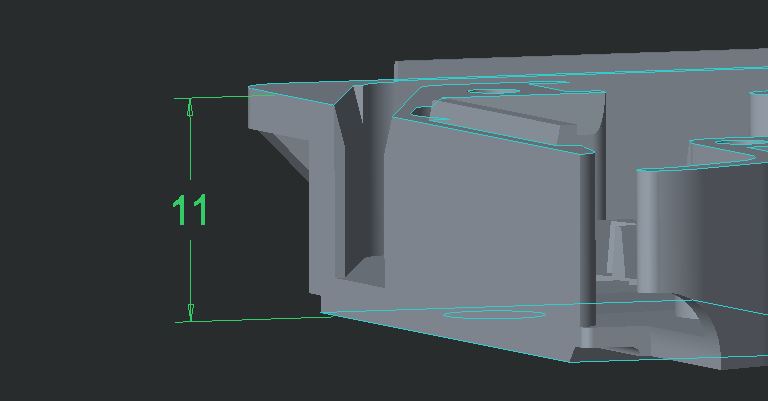

    I was doing some comparing of model driven dimensions vs. added dimensions (Annotation Elements within an AF)  yesterday. The part I am defining has many cavities and steps, and it's a little difficult to see what the height dimension applies to when the entire model highlights if that model dimension is selected. Sure, the first feature was originally a nice block, but now the part  has so many different heights that it's really not clear which surfaces that height dimension (11)  applies to, unless you are looking at a straight on (2D!) view:
    Knowing how 2D views are frowned upon in MBD, I rotated the view and selected the driving dimension to see how clear this really is to the viewer, but the entire part highlights when you select the dimension, since this dimension is the overall height of the first extrusion:
    With an added dimension (AE), since you explicitly select two surfaces, only the surfaces at that distance  highlight when the dimension is selected, which makes it much clearer for the viewer:
    The one caveat was that all surfaces on the plane highlighted, and sometimes there are surfaces on a common plane for which a tighter tolerance should be held on only one of those surfaces, so highlighting all the surfaces on that plane can be misleading and costly. I was trying to figure out how to add the model dimension to an AF, in hopes that I could better control which surfaces are associated to that dimension, but wasn't able to select driving dimensions (even though they are Annotation Elements).
    So, to re-state my question....if driving (model) dimensions are considered Annotation Elements, can I add them to the AF such that I can have better communication with the viewer? I am using CREO 3.0, M110.
    Thanks for any input!

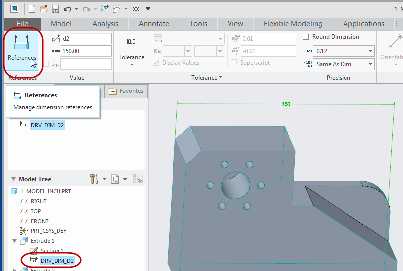

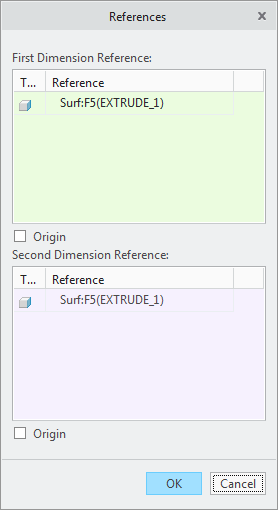

    In Creo 4.0 we now offer the capability to manually add semantic references for Driving Dimension Annotation Elements (DDAE).
    When you select the dimension, the Dimension ribbon appears and on the left side there is a button called References
    If you click on that button, a References dialog will open where you can add the surfaces you want to be the semantic references:
    There is an issue with F000 where it seems these surfaces aren't highlighting when the dimension is selected, but the references are there nonetheless and will be passed on to any downstream software that wants to use the semantic references. We will be fixing the highlight issue in an upcoming MOR.
