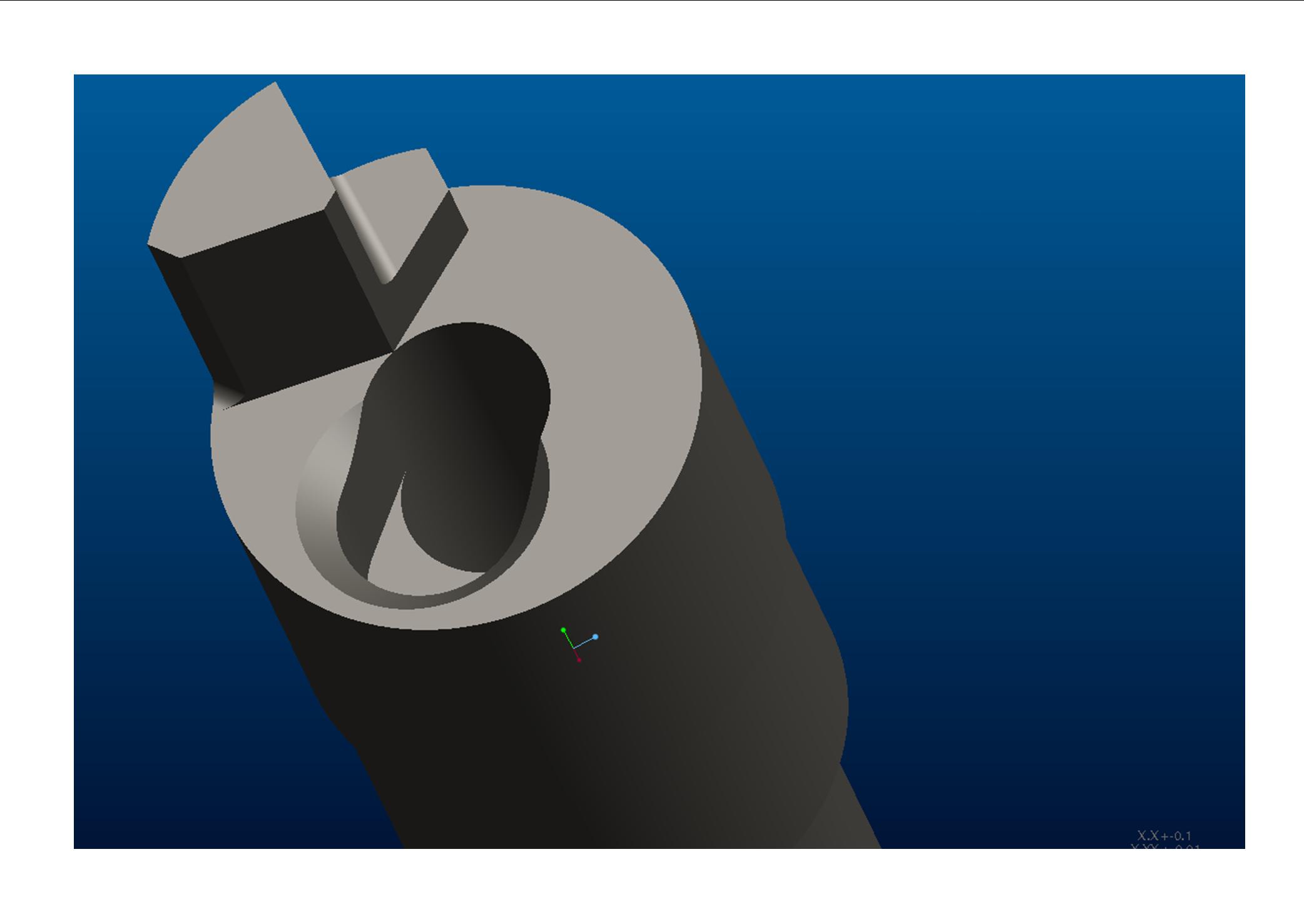

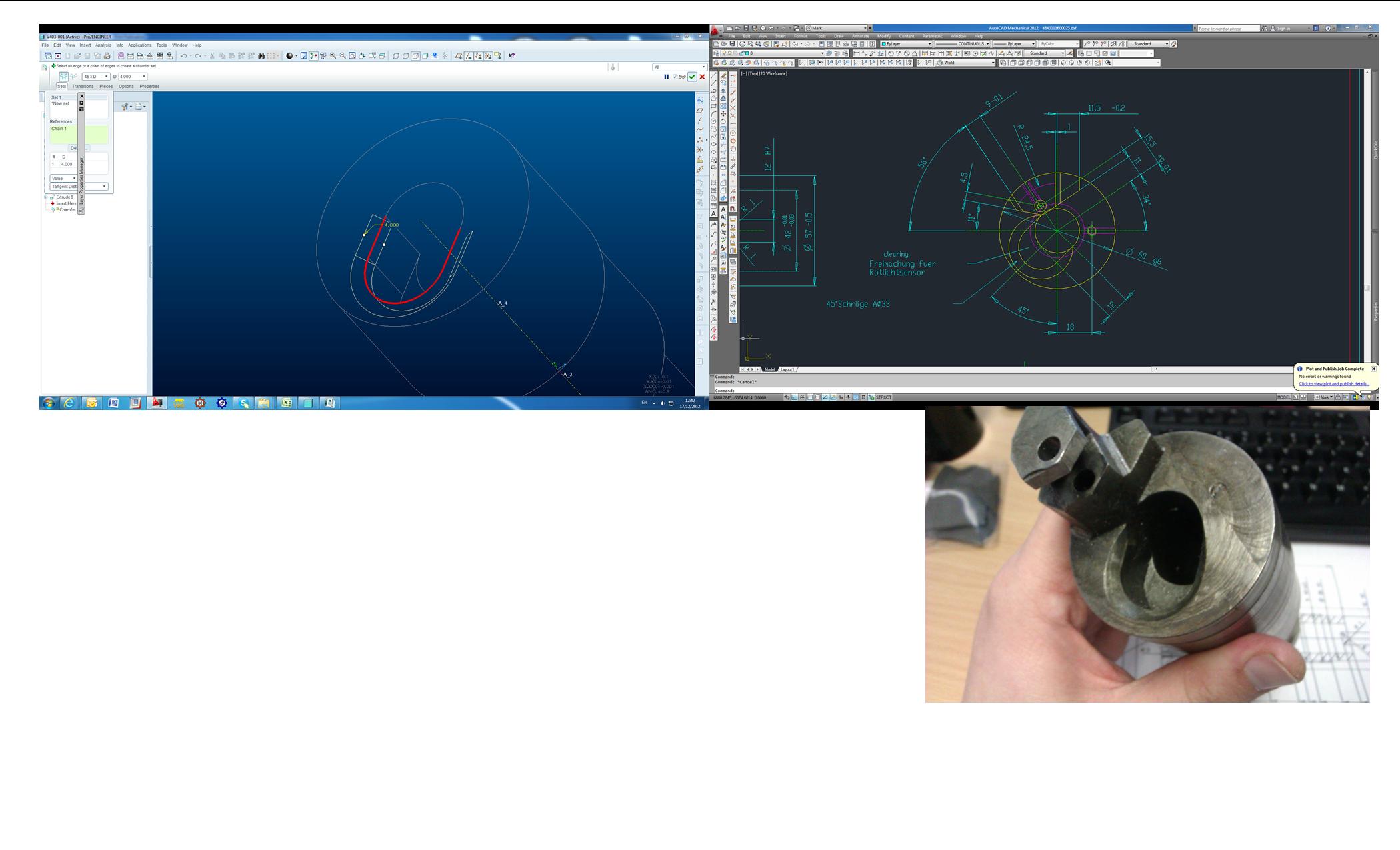

I having problem creating this feature I have attached some pictures to help illustrate what I am trying to achieve.
I have started with a Chamfer tool with the following settings:
45xD
Set Chain 1 – Standard selected 3 sides,
I have also tried Rule based and selecting Partial loop but the model fails to generate when I exiting the sketch.
Hope you can help with some pointers please as I am new to proE coming from a SW background. Thanks in advance for your help.Publication1.jpg

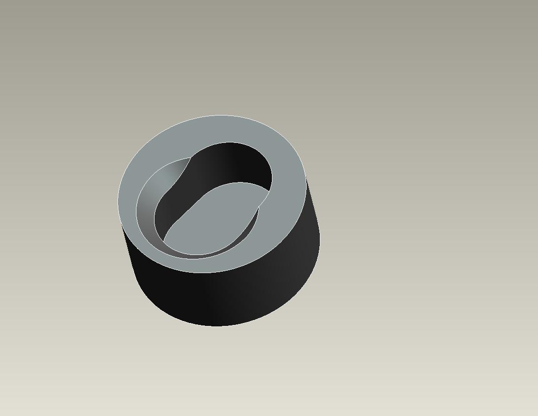

Hi All,

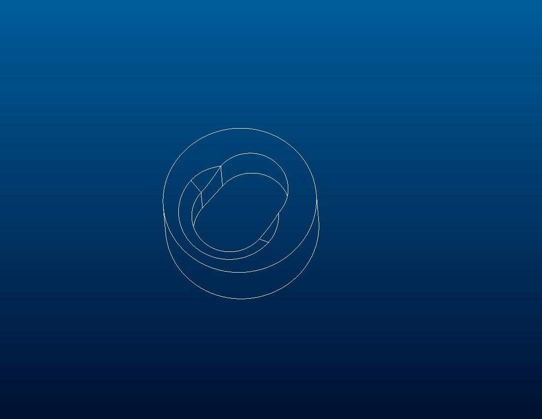

hi,
below i have added two images, if that is what you are looking for then you have to use the swept blend option and two guide curves. the cross section is triangular.
ptc-46444611-VisitorAuthorAnswer

Hi All,

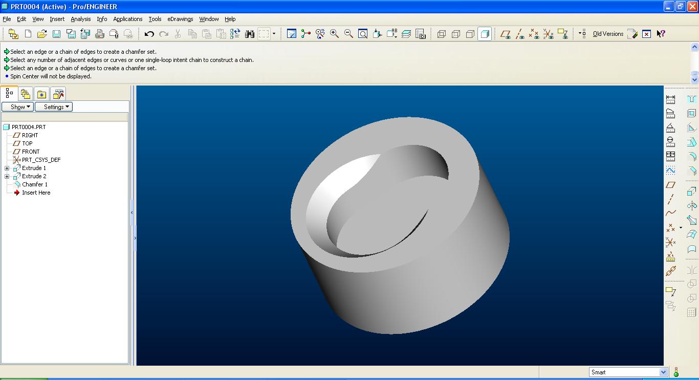

in my last post i had shown two jpegs shwoing the swept blend option to put the cut.
well in pro/engineer also u can use only the chamfer option to get that particular cut. see the image below.chamfer.JPG
in chamfer select the detail option before selecting the edge and then select only the circular edge..you would get the desired result.

Actually, looking at the geometry, and imagining how it would most likely be cut, I'd say a simple revolved cut would be the most accurate and easiest, using the axis of the cylinder on the end there. Most likely (cheapest) the machinest went in there with a simple chamfer tool and plunged to the correct depth, or interpolated a circle. I don't think there's a need for a sweep etc.
January 2, 2013
Looking at the original input (lower right image), there is an obvious elongation of the chamfer path. I think the discussion morphed into a lesser "compromised" solution. As a matter of fact, the chamfer appears to blend tangent to the center "through" hole.
I hate seeing this when the modeling tool is more than adequate to do the job correctly.
http://communities.ptc.com/servlet/JiveServlet/showImage/2-193539-42608/Publication1.jpg
Patriot_1776
January 4, 2013
Well, when I open the attached picture, they look compressed left-to-right. What looks like a circle in the small view gets highly elliptical when you open the pic. You can tell by the fact that even the cylindrical portion in the guy's hands looks elliptical, even the other views look elliptical. Without the part in hand this is one of those things that's hard to pin down.
