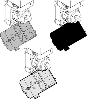

I am working in IsoDraw version 7.2, and I need to show a simplified outline (the customer calls it a “phantom”) of the assembly to help with locating the components of the assembly that are called out. Also, the simplified assembly needs a different color fill than the components(s) being called out.
I have imported IGES output from SolidWorks. There is great amount of detail that needs to be cleared out (numerous holes, vents, etc.) to simplify the assembly.
I have experimented with settings for converting to 2D to try to reduce some of this detail. Hiding, deleting, or using no pen for components to clear out the detail seems a little tedious.

First, I would consider playing with your 3D Projection-Set options when converting to 2D. Look up information on these settings in your online help manual.
You may need to enable/disable:
  • surface borders as necessary
  • Fill contour option from the 3D Projection -Set window to add a contour fill around the component.
Consider doing a separate conversion of only the phantom assembly. To simplify the phantom assembly, Ungroup and edit the geometry so that your view is simplified. Group the elements back together and re-apply object information as necessary. When edits are done, copy/paste it back into your drawing.

Depending on your definition of 'magic bullet' there is a feature available in 7.3 f00 and beyond. What it allows you to do is take you're 3D model and apply a fill to it. Once you project to 2D it maintains that fill.
Sorry that I didn't get this to you sooner but I just installed this version last week and hadn't had a chance to experiment. Worked pretty slick when I tried it though.

I don't know if I catch you right. But I think with IsoDraw it is easiest to create outlines with "Contour"
Do you need something like that? That's something which can do with one step ...

For the drawings I have been working with, "Generate Contour" has been hit or miss. Most often, it will not trace the complete contour of the component. When I try to fill the contour with color, random chunks are missing. I have to completely isolate the component to get a full contour.
It could just be my drawings.

In 7.3 - You can use contour sets to create different fill colours and then apply these sets to 3D object before converting to 2D.
