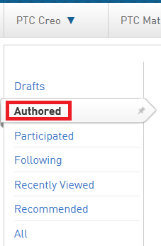

to see your discussions, click Browse > Content > Authored.

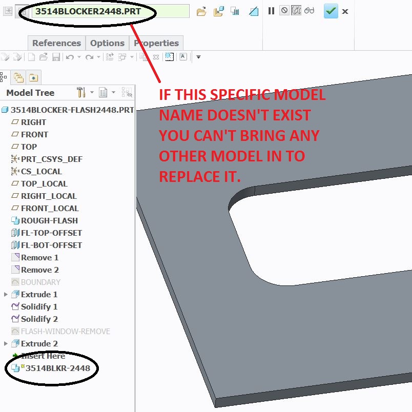

August 5, 2015
James,
Yes the whole replace routine would be a very long and confusing video.
I hope a series of snapshots will describe this confusing process.

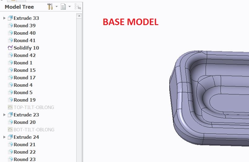

Below is the starting model.

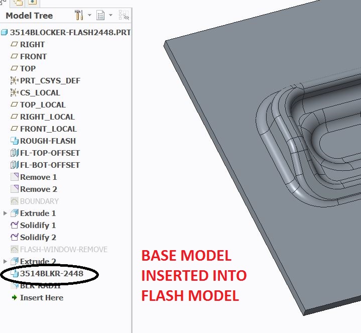

Which gets fitted in the below part model.

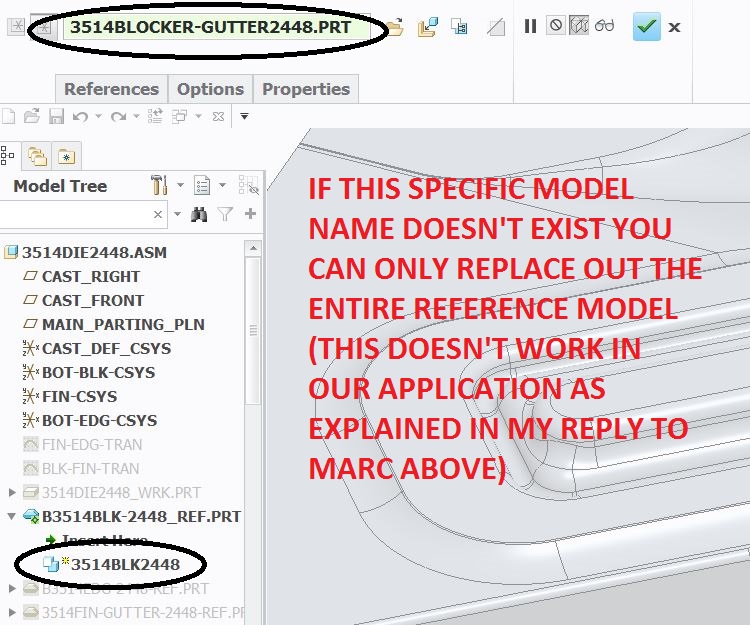

The quandary develops when I have to retain the naming of the base model; otherwise I can't replace out the needed model.  (Nothing will show up in the replacement box)
See below.

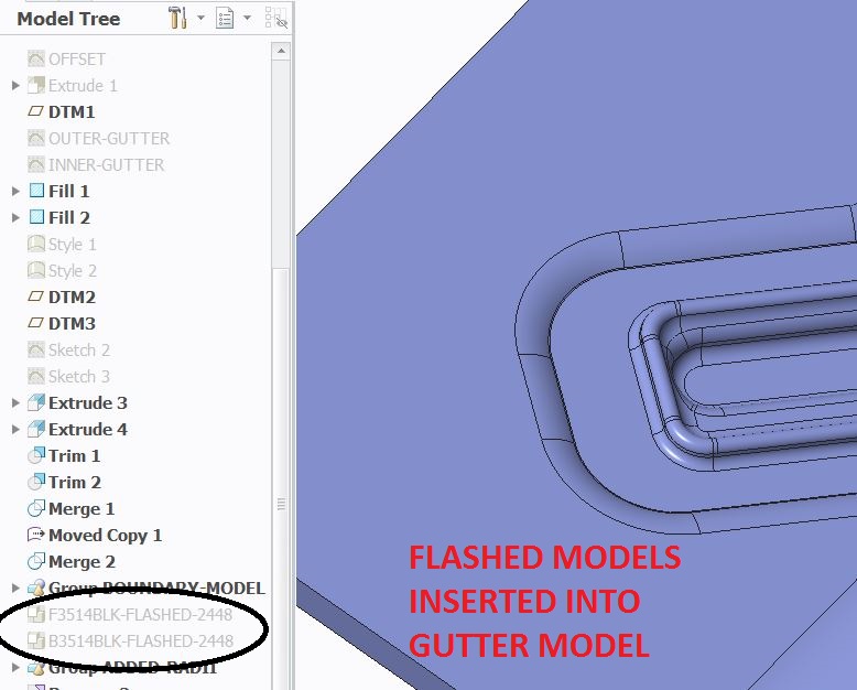

Below is the blocker models inserted into the gutter model.

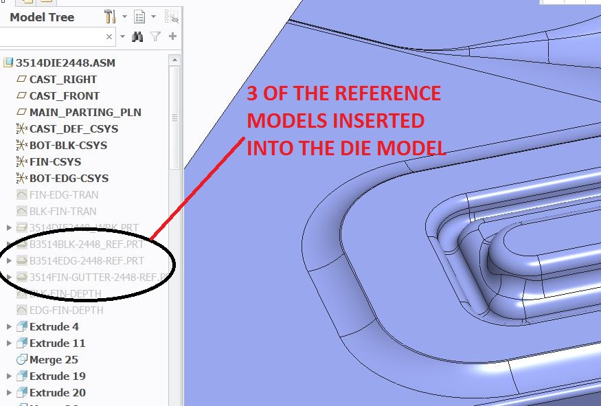

Below shows gutter models inserted in the die.
Notice that there still is an issue of matching up part model names.
These pictures illustrate the progression of the tedious name changing as explained in my original post.
Hopefully this shows the unnecessary struggle that needs to be followed in order to carry new changes through our dies.
Even more hopefully there is a way around this, or it might be changed in a future Creo release.
