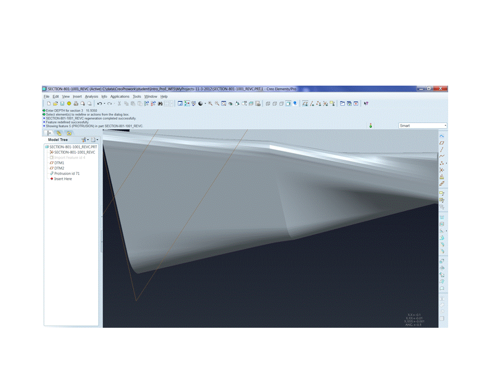

I'm looking for some expert advise or a tutorial on blending. I'm using Blend Protrusion on a complicated shape using multiple sections, after the 3rd section the blend has a mind of it's own and starts to twist whatever way it wants. I can also see this twist starting in the 2nd blended section. I made sure all the arrows are facing in the same direction but this doesn't seem to help. Is there a better way? In I-Deas and NX I used Lofting is there something like that in Creo?

Nov 28, 2012 1:28 PM UTC

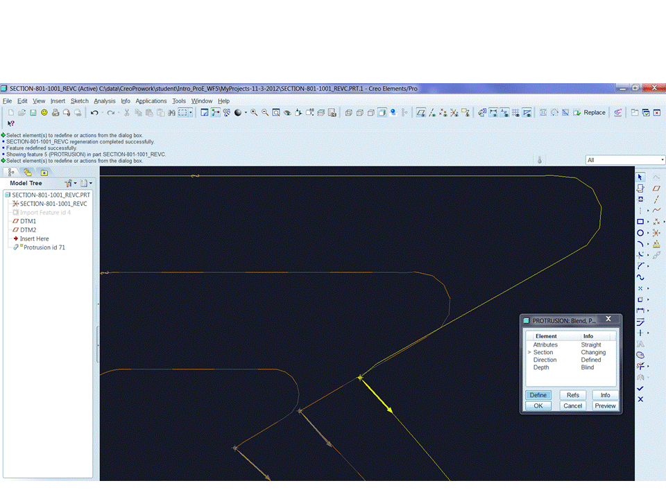

Do you have a screen shot of what's happening? Blends are usually not difficult to figure out. When you get into Swept Blends and Variable Section Sweeps with multiple trajectories, that can start giving odd twisting motions that require additional constraints to fix.
For a blend, it if't twisting, check your start points. You said you made sure the arrows in the sections were all facing the same direction. That's good... but you also have to make sure the start points are in the same relative location and that you have the same number of points in each section. If you do not have the same number of sections, you'll need to add one or more Blend Vertices to make up the difference.
I've never seen a simple blend misbehave when these guidelines are followed... but anything's possible! If we could see a screen shot, I think I could diagnose the problem right away.
Thanks!
-Brian
mrubino1-VisitorAuthor
Nov 28, 2012 6:19 PM UTC
Hi Brian, I appreciate you answering my blend question. I'm attaching a screen shot as you requested.
Mike
