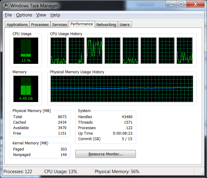

We are using Creo 1.0 M030 and we have experienced this since WF5. The loading times for models and drawings becomes a huge factor in my efficiency because I spent so much time waiting. Even switching between drawing sheets can take quite a while. My computer has a SSD, i7 processor with 8gb RAM. Win7 x64 and a quadro 3000M. I am using a Dell M6600 laptop. Are there any settings to increase performance of drawings or something that I can do to help with this?

Aaron,
open Task Manager and look at Performance tab (CPU Usage) during loading of your model/drawing. Make sum of CPU usage of all threads and you will get CPU load. If the sum is ~100% then the CPU is a bottleneck. If not then the problem is somewhere else.

I have attached an imagine while using the drawing. I will have to wait about 2 minutes for the page to load if I switch pages (load times dependent on the page I switch to) or if I activate another window and then reactivate the drawing window. The CPU never reaches more than 18% and cores 4,6,7 never show any activity. My boss also has the same type of computer and experiences the exact same thing so it is not something about my computer. Would submiting a ticket solve anything?

Aaron,
13 % is an average CPU load.
8 * 13 = 104 % CPU usage. So it seems to me that CPU could be a bottleneck.
You can try the following:
>>> in Task Manager activate Processes tab
>>> select xtop.exe process, press right mouse button and click Set Affinity command
>>> now you can see the list of CPU cores assigned to xtop.exe
>>> check CPU 0 and uncheck all others
>>> load your model/drawing ... xtop.exe will use only first core and you will see the real load percentage for "1 CPU computer"
>>> you can use Set Affinity command again and test another combination of CPU cores

Martin,
It appears that you are correct, if I use a single core it stays maxed at 100%. So the only way to increase the model load times is to upgrade to a faster CPU? Making the models smaller really isnt an option.
