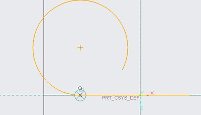

I have been running into this issue where when I select a point at the end of a line while doing a 3 point arc it does the following behaviour. It should be a pretty easy fix however I have no idea how to prevent it.
I am using creo parametric 9.0
If the behavior you are referring to is to make it tangent, you can move the mouse back to the start point, pause, then move perpendicular to the existing line to prevent automatic tangency.  The same movement also works when first starting the arc.

Thanks a lot this works perfectly and yes the behaviour I was mentioning is making it tangent, interesting I didn't realise that was what I was happening, I should pay more attention to the constraint symbols.

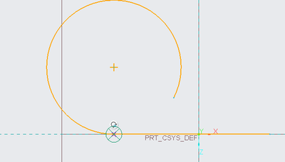

I am attaching a video on the issue I was facing, it seems kdirth's solution works to resolve it.
So the first shape I make is what I want to achieve for reference. The second attempt is me making trying to make it by defining the line first, failing and then using kdirth's method to successfully do it. The third attempt attempt is what I had been resorting to doing, that is holding shift and clicking somewhere near the start and then constraining the start point of the arc and line together.
