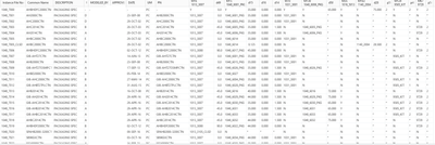

Hey,
Can you please post some pictures with the process? I want to see how the family table is set, and how you name the instances or other variables so I can follow your advice.
Thanks!
Here is packaging for one of our poducts:
Far left is our instance names in the family table, then common name and other drawing parameters.
Part number, Box instance, orientation dim, actual part instance, placement within the box, foam/carboard, 2nd part, part placement, more cardboard, screw packs, foam.......
