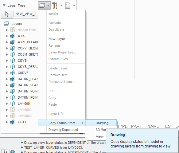

do you want to retain layer status dependency all the time automatically or is the problem the resetting of layer status when you create the independent view?
You can copy the layer status from the drawing after you create the independent view:

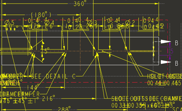

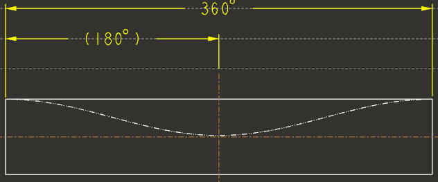

As i said from the beggining is that the easy way doesn't work because the complexity of this preatty easy assembly. More precise, from this:dependent on the drawing layerdependent on the drawing layer
it becomes this:Independent from the drawing layerIndependent from the drawing layer
The question is: in the step 3-third parantesys- of the drawing procedure: blanking the layers: is it possible to blank the layers ONLY IN THAT VIEW? Otherwise...

I have three views: two depending on the drawing layers and one, independent of the others two representing the unwrapped cylinder, where my curve should appear. Unfortuantely if I copy the layer from of the two views, my unwrapped view becomes drawing dependent. And if i copy a 3D layer structure it will blanks me other layers that I want them shown. I cannot manualy change those layers because there are more than 100 layers and it will be difficult to undrstand which one is mine.

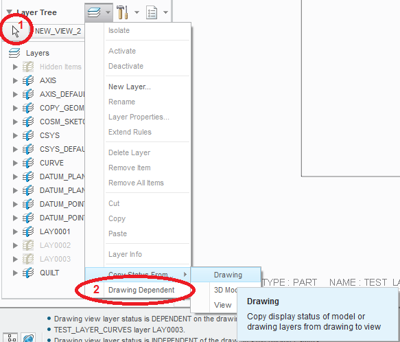

Manipulating layers in Creo drawings is a very confusing process.
So to clarify, "drawing independent" view has a layer state that can be controlled separately from the drawing's layer state.
"Drawing dependent" views do not have a layer state - their display is governed by the drawing's layer state.
In general, the views that you create are "drawing dependent", unless you go through a procedure to make them "drawing independent".
Please refer to this figure that I copied from an earlier post in this thread:
1) using the "arrow" button and selecting a view from the graphics area or from the drawing tree will cause it to become "drawing independent".
Actually, after clicking on this arrow, you can quickly see which views on the current sheet are "drawing independent" based on the color of their view outline ("drawing dependent" views will have a different color)
Another thing is that whenever you turn the view to be "drawing independent", Creo will often unblank all layers in that view (what you illustrated in your last post).
But most importantly, you are indeed free to blank/isolate layers and the state will be preserved just for that view (just remember to save the layer status).
Also shown in the figure is the way for this view to "copy" the layer state of the drawing, model or another view.
2) Using the "Drawing Dependent" function will turn the "drawing independent" view into a "drawing dependent" view.

As you can see in my images attached above, when i made the view independent it unblanks a lot of layers which should be blank, Sooooo...

nalexandru
(To:psobejko)
Yes, I'm preatty sure you don't understand where is the problem.
Did you see my screen shots earlier? If I have a symbol that is attached to that view and I blank a layer used in a note attached to that symbol it will be blanked also? What if I DON'T want it blanked? There are almost 100 layers.
I suppose i have to manage it differently
Thanks for the help
