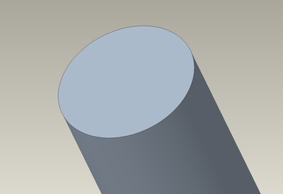

Angular circle ?!
Model_1975
Angular circle ?!
how can I setup the amount of flanks for a circle?
Since I am using creo 9 that behaviour is "new". When I used 6 it wasn´t doing this - most probably the setup was correct.
I am sure its an easy fix. thanks in advance. 

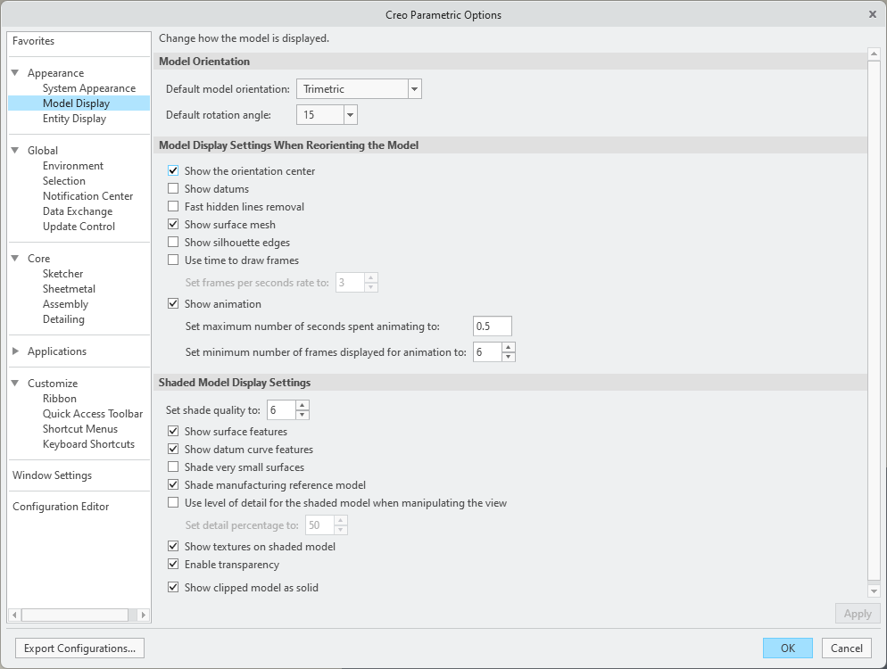

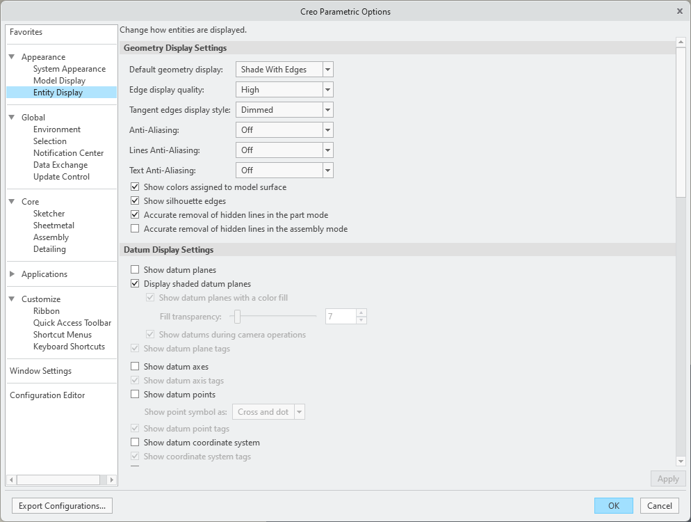

It's a graphics setting within Creo. The geometry is a precise circle, you're just seeing how it is rendered when the visualization settings are somewhat low.
https://community.ptc.com/t5/3D-Part-Assembly-Design/How-to-change-the-circular-line-and-arc-resolution-in-creo/td-p/308855

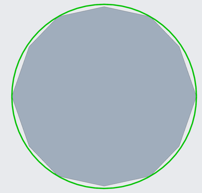

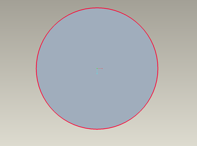

thanks for the hint - I tried the settings in the post but I have the feeling that I gets worse. I tried some values (15, 30, 50, 1) especially for shade_quality but no very noticable change. I am using the HP ZBook Studio G9 - I cant imagine that the problem is the hardware...
The strange thing is the third pic in my post - a creo 6 model is rendered nicely but in the same time and same dimensions a creo 9 model is rendered not so nice. Surely its just for me strange and there is a explanation to it.
Thanks for trying to help.
StephenW
(To:Model_1975)
Be careful with shade quality setting. I changed it to a larger number and it made working with my large assemblies impossible.
I went back to a setting of 3, which is the default (at least in Creo 6 and previous)
I deleted the three values in my custom config. Now they are at default again.

Try reducing the model accuracy to a tighter value and report back if this changes the display. If you have a high aspect ratio part (length of cylinder is very long compared to the radius of cylinder) then this can influence the nature of the rendering of the geometry.
You can also set the length of the cylinder equal to the diameter and see what happens.

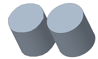

Part accuracy can also cause the same visual effects.  Below, the left cylinder (Ø10 x 10) has an absolute accuracy of 0.1 and the right is 0.001.  Relative accuracy will also make a smoother circle on small parts.  Starting Creo 7.0, absolute accuracy became default.
Model_1975
(To:kdirth)
Thank you too, I changed the value in the settings (File > Prepare > Model Properties > Accuracy) from 0.015 to 0.001 and thats what I searched for! 😀
