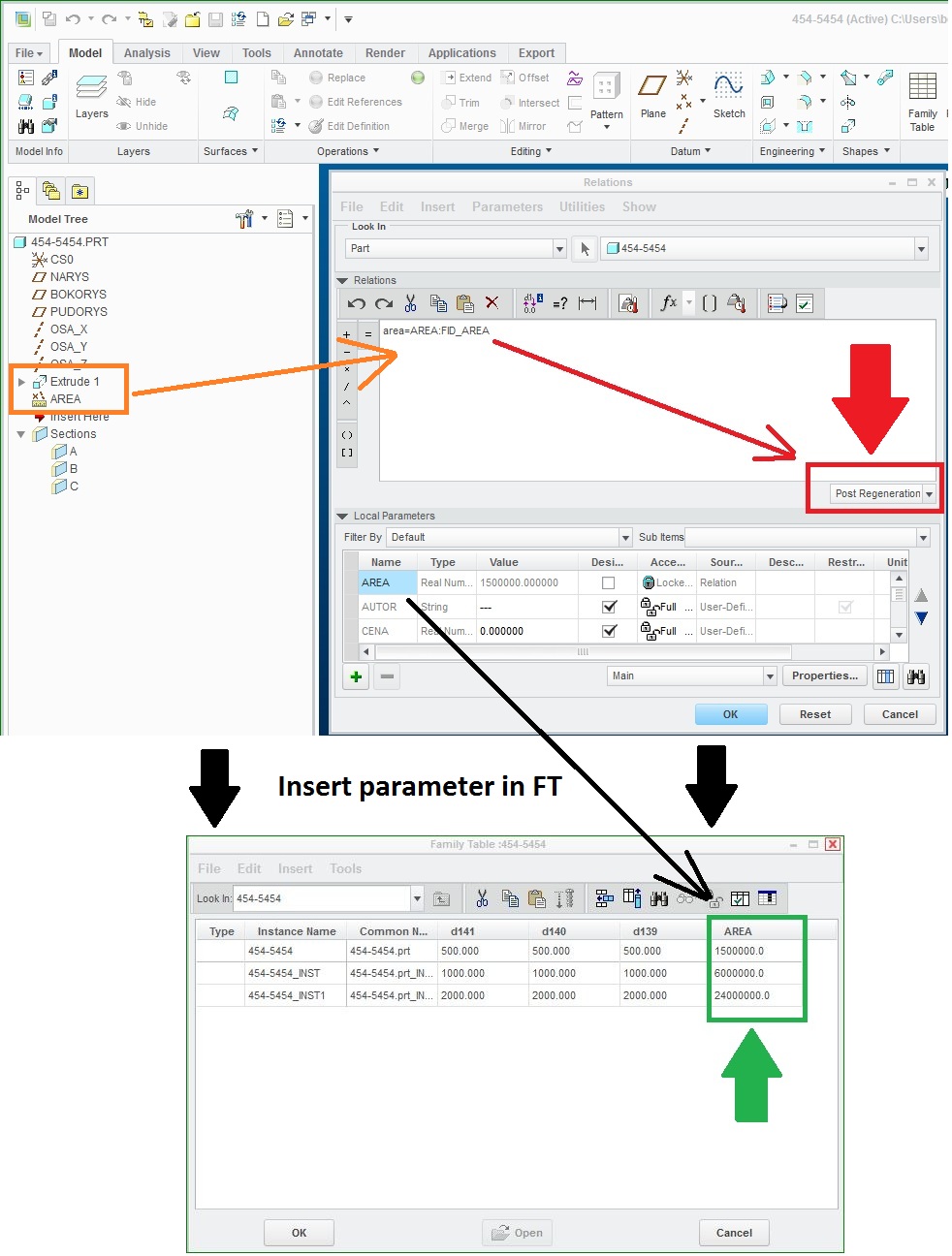

put your relation for AREA calculating in POST REGENERATION relations. (see attached picture). In my opinion it means that ProE will do following:
- regenerate model (change of size)
- calculate relations
Thank you,
it works fine,

Never noticed that button. Great tip, Milan!
From the help files...
3. If you specified any relations as Post Regeneration, the system solves these relations after the regeneration is complete.
