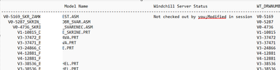

Is there a way for Creo to automatically generate a drawing tree? I'm not talking about the assembly drawing tree in Creo interface. In ASME Y.14.24 Types and Applications of Engineering Drawings, section 16, there's a Drawing Tree section. I'm talking about this. I attached the screenshot of it here. I have to make this drawing tree, and we have a lot of parts. It just doesn't make much sense to do it manually if Creo already has a feature for this. Thank you so much!

As far as I know there isnt something like this. Alternative to this is saving the model tree and then throwing it into chatgpt to build a tree generator for you or using excell.
requested functionality is not implemented.

If you have Windchill, you can get an indented assembly structure list. Drawings are not 'connected' only the assemblies and parts.
In short, no.  You can use an indented BOM if I remember, but not have separate boxes.  We're looking to do the very same thing.
