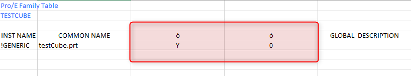

In some models, when exporting a family table to Excel, it is adding random columns or creating duplicate columns for some parameters.
After saving the Excel file, the family table will not update anymore and delete every row.
The column "o" shown below, is added after adding a parameter column "widthMM".

1. What version of Creo are you using?
2Submit your issue here: https://support.ptc.com/apps/case_logger_viewer/cs/auth/ssl/log
MartinHanak
(To:BWS)
please record video showing your problem and upload it. If it is possible upload Creo file, too.
