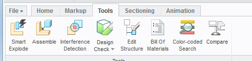

Hello all,
This is probably a simple question, but where in Creo View is the BOM tab/option?  I have looked under the Tools tab but all i see is Design Check Review.
Thanks in advance.
slapha
(To:bhart-2)
Depends on your licensing. The BOM function is under the tools.
This is the MCAD license:

Standard license has the Bill of Materials option as well.
