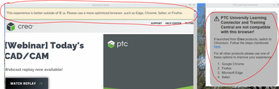

How to avoid this error
Creo 4 / windows Edge
"This experience is better outside of IE 11. Please use a more optimized browser, such as Edge, Chrome, Safari, or Firefox".
Any help would be appreciated.
Thanks rct

Creo 4 doesn't use the Edge browser, even if it's installed in Windows.  To avoid this problem you need to either switch to a newer version of Creo (with an updated embedded web browser) or just use one of the stand-alone web browsers outside of Creo
there is config.pro option which enables you to choose one of two embedded browsers.
WINDOWS_BROWSER_TYPE IE_BROWSER or CHROMIUM_BROWSER

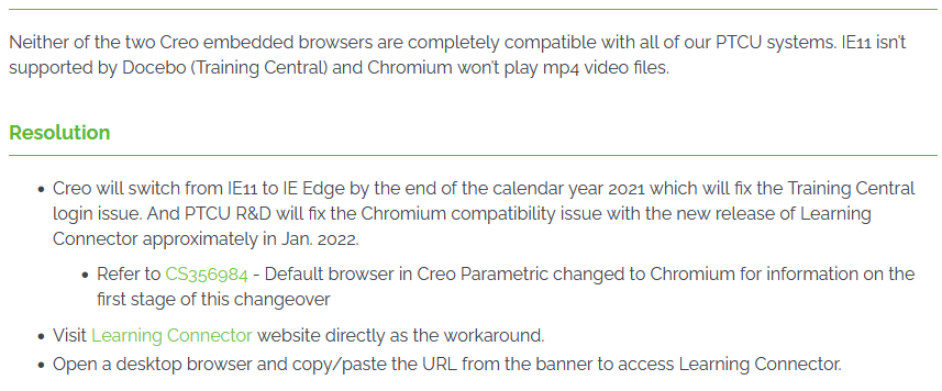

Neither one is compatible with the learning connector.
VladimirN
(To:RC_1972)
Article - "Unable to connect to LearningConnector starting from Creo Parametric 7.0.0.0": https://www.ptc.com/en/support/article/cs346017
