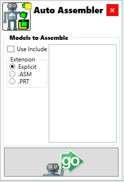

KE_2142943
(To:OV_10001888)
I don't know if this is something our Creo guys came up with or if this is a standard Creoson tool but we use something called Auto Assembler. It's exactly what you're talking about.
