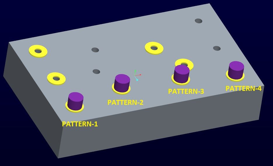

I use CREO3 M130 and i have some problems with the patterns functions.
In this sample i have do different holes by patterns (dimension, axis, points and direction). In the assy a would use the pattern function by reference only.
1) Firts, for th part 2 (Washer) is it possible only for the pattern 1 and 3 not for the 2 and 4 Why ?
2) Second, i would like assembly the part 3 (Screw) on the washer and use the pattern by reference too. And in all the situations, not working.CREO3-M130 - PATTERNS.jpg

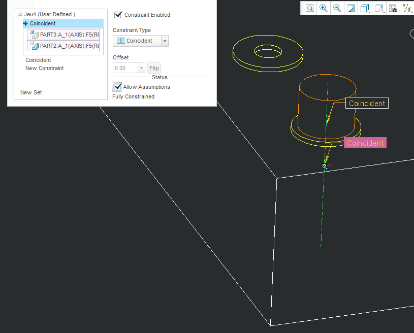

Change constraints for washers and screws from axis-axis to cylinder-cylinder. In this way all patterns works.
ldrutel
(To:PCV_co.)
Great , his solution resolve the first point. Now i can pattern the all the washers by reference.
But, for the screw, i have change also the assy axis/axis by Cylinder screw/Cylinder washer and the pattern reference not work. It work if i assy the screw : Cylinder screw/Cylinder part1 and gap Surface screw/Surface part1 but this solution is not really the best.

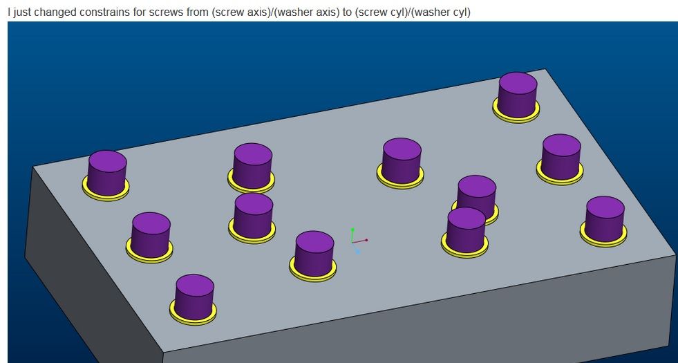

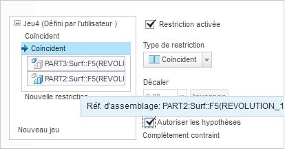

I just changed constrains for screws from (screw axis)/(washer axis) to (screw cyl)/(washer cyl)Capture.PNG

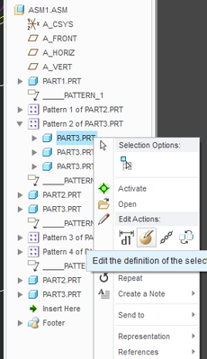

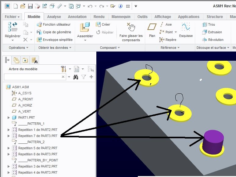

ldrutel
(To:ldrutel)

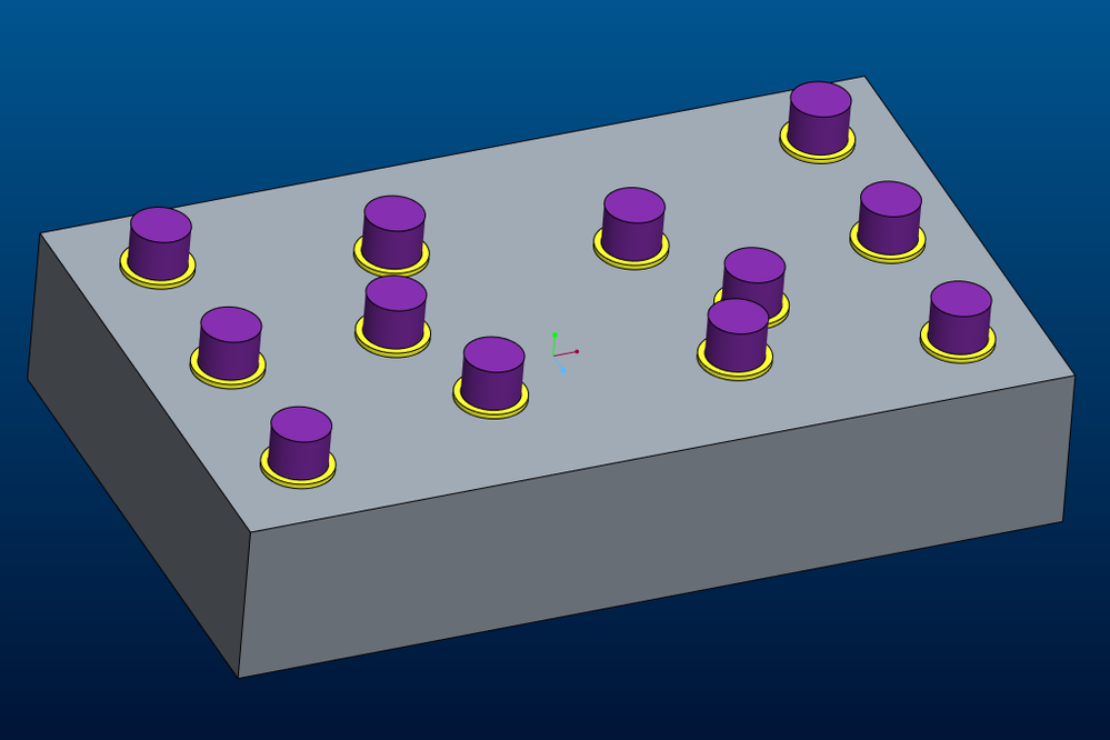

To add a example of my problem: In this same of assembly create with CREO2, i have 2 same assembly.
I have take this assembly with CREO3 BUT on the left i have no touch the definition of the pattern and then all is good, and on the right i have take the pattern function for redefinition and now, we can see that the result is not the same. The pattern function don't crash but all the instance are on the same place.

You simply selected wrong reference for constrain, compare with axial constrain on left side.

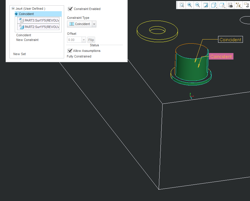

Simply, change constraints for every component which is not patterned as it should from axis/axis to surf/surf:
Old constraint:
New constraint:
