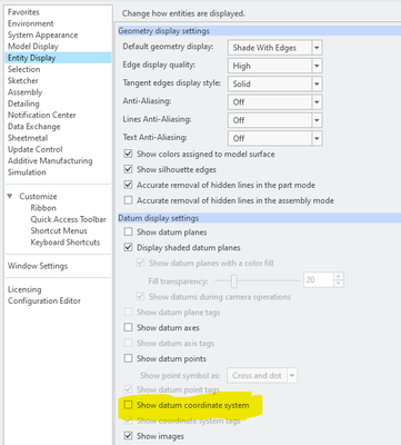

Does turning this option on do what you are looking for?
display_coord_sys    yes
aputman
(To:mkajdan)
That does the exact same thing as turning on CSYS display.  That check box and the CSYS display button are linked.
mkajdan
(To:aputman)
But when you start a new session of Creo, it will already be on.  There will be no need to select the CSYS display button to turn them on.
config.pro option ... display_planes yes
However, you have to take into account that CSYS can be in the hidden layer.

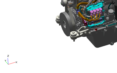

thanks all but maybe i've phrased the question poorly... i meant if there is a way to show orientation of first csys in left lower angle as in Creo View.
In Creo Parametric there is no csys like in Creo View.
Creo Parametric uses Spin center which can be placed on model geometry.
