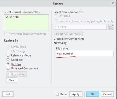

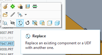

Have you tried Replace By Copy?

If the model must have a unique file name, then you must save it at some point in the process.
One alternative is to rename the part in session and then save it. By renaming it in session the part can be given a new unique name while in session and when saved will use the new name.
This would save you the deletion and replacement of the part in the assembly when you need to create a "new" part.

If you are using Windchill, you can use save as from within windchill and use the "next" button and you can copy and replace at the same time.
Thank you everone!
