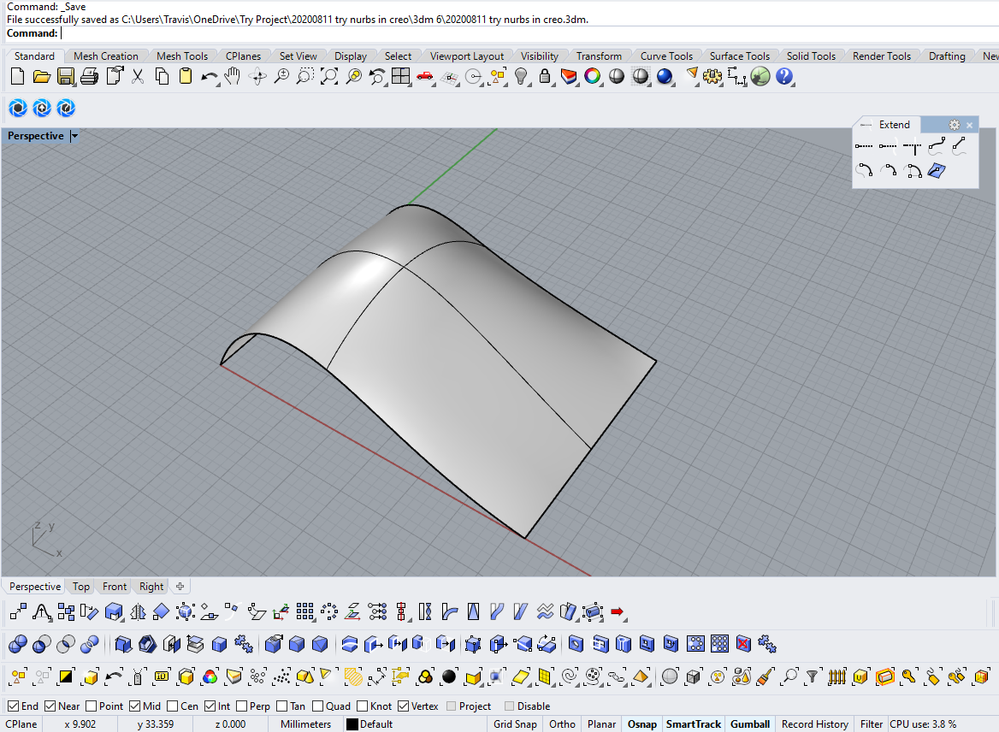

Hi
Can we import NURBS surface from Rhino, convert to sheet metal for manufacturing?
can split it into many smaller sheet metal? flatten?
Attached rhino file:
