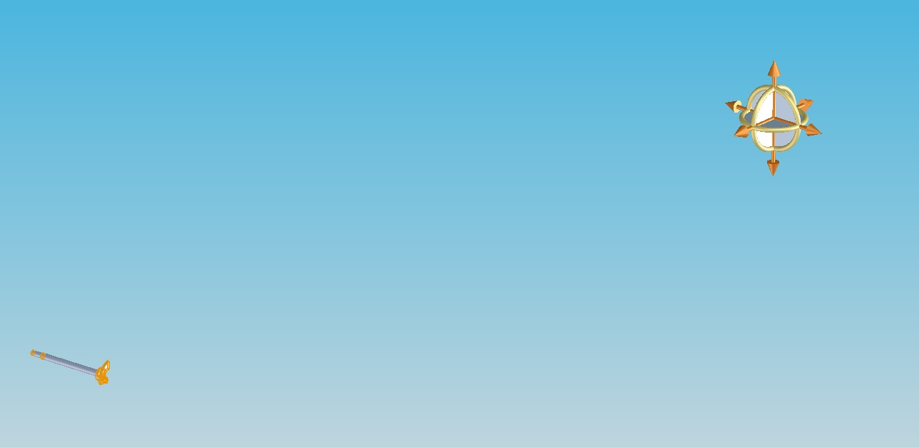

Is it possible to change the positioning centre of a part or an assembly? In the picture below the moving centre is off the assembly by 1500 mm and I would like to move it to an centre axis of one of the parts.
Any help is appreciated

I selected the Position command and then selected the assembly from the tree.
There are a couple of assy's that have this problem, but I think they are all from an older program versions. This has never happened, to my knowledge, on new parts that I have created on version 19.0. They probably inherited the problem or they were created during transfer I think to the newer version.
This is more of an annoyance than a problem really. Was just wondering if there was a command to move the "positioning centre".

I generated this simple model.
The centre of the 3D-Co-Pilot ist not in the centre.
To turn the model on its own axis i have to use the dynamic positioning.
It would be better if the 3D-Co-Pilot is always in the centre. Maybe the centre of the cylindrical surface.
Furthermore it would be nice, if i could define the centre on my own.
Johannes
The assembly has his origin outside the models, where you can see nearby the copilot.
Reason could be:
the first part in the assembly had this position, other parts have been included, later other parts have been deleted.
But the origin of the assembly is the same as before.
I changed the origin of the assembly and it looks good now.
See attached file
best regards
WoHo
If you pick the model from the screen rather than pick it from the Structure Browser, and have the "Selected" option selected in the Position dialog, the 3D CoPilot will be centered on the point that you picked.
