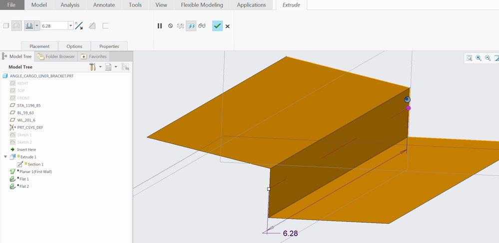

Use the Extrude tool in sheet metal.  Sketch your profile and extrude as normal.  The sheet metal extrude will automatically add bends to any sharp edges.  See attachment.

Creo 4 M020.  It's not a new functionality.
It's the extrude button right in the middle of your screen shot.  At the top of the "Shapes" section.
If you have existing geometry in your sheet metal part the Extrude tool will default to remove material.  Turn that button off to create geometry.
For some reason in my case when I click Extrude, I get an option of making a sketch but there's no option for the functions that you have in your screenshot.

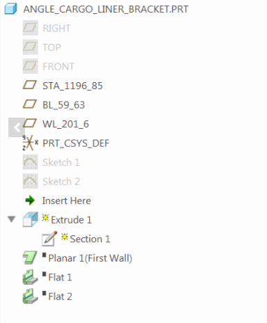

You can't create sheet metal features before the sheet metal "first wall" feature.  Move that extrude below your first wall and you should be set.  Or start over from scratch - you'll have to anyways if you want to use this method.

The "first wall" is a special designation in sheet metal given to the first solid geometry feature in a sheet metal part.  Your part already had it's first wall designated - the Planar 1 feature.  That is automnatic since it was the first feature.
In sheet metal, you can't insert or create solid geometry before/above that first wall feature.
Just delete Planar 1, Flat 2, & Flat 3 and then create your extrude feature.
Thank you! 🙂 Got it. So easy. It's interesting that they just don't work together even if the feature is suppressed.
