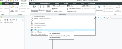

I just installed CREO 10.0,  I was 6.0 before.  I can't figure out how to edit a drawing symbol in 10.
Best answer by tbraxton
tbraxton
tbraxton22-Sapphire IIAnswer
June 15, 2023
HBreton10-MarbleAuthor
June 15, 2023
Thanks!  I couldn't see the annotations drop down.

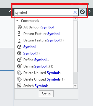

June 16, 2023
you can use Search tool to find some command.
