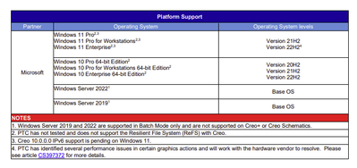

llie
(To:tlaak)
You need to go to PTC website and see what is supported for Creo 10 and Windows 11. It is not showing your version of Windows 11.
https://www.ptc.com/support/-/media/support/refdocs/Creo_Parametric/10,-d-,0/creo10_hardware_notes.pdf?sc_lang=en
