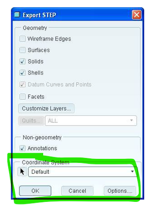

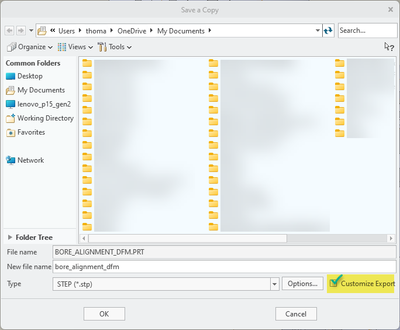

In Creo 10.0 and above, when converting stp files, am I not able to set the coordinate system?
Please let me know if there is a way to set it with the coordinate system I made

Choose the customize export option when exporting the STEP file. This will invoke another window that has the selection of the csys used for export.
