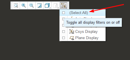

This seems to work in Creo 3:
~ Activate `main_dlg_cur` `igToolbar_AncestorIGT_IGT_GRP_inh407412841.proe_win|.mcs29658718_mp|select_a\
ll_check` 0
~ Activate `main_dlg_cur` `main_dlg_cur`
~ Command `ProCmdViewRefit`
~ Command `ProCmdModelSaveAs`
~ Select `file_saveas` `type_option` 1 `db_617`
~ Activate `file_saveas` `OK`
~ Activate `UI Message Dialog` `UI Message Dialog`
~ Activate `UI Message Dialog` `ok`
~ Select `intf_profile` `pdf_export.pdf_raster_dpi` 1 `600`
~ Select `intf_profile` `pdf_export.pdf_color_depth` 1 `pdf_mono`
~ Select `intf_profile` `pdf_export.PDFMainTab` 1 `pdf_export.PDFContent`
~ Select `intf_profile` `pdf_export.pdf_layers_opt` 1 `pdf_layers_none`
~ Select `intf_profile` `pdf_export.pdf_font_stroke` 1 `pdf_stroke_all`
~ Activate `intf_profile` `OkPshBtn`
Use the "select all" datums instead and should work ok.
José

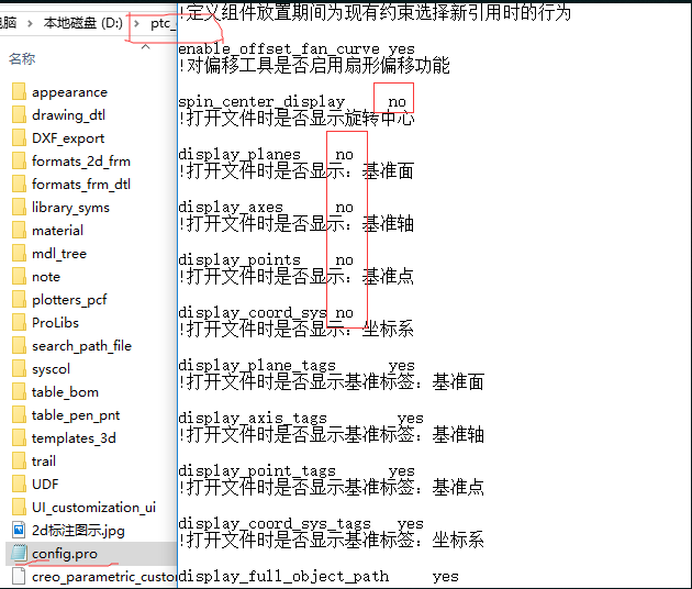

I created a config file with all the datum display set to no and included the command to open the config file each time i need to create a PDF.
Nithish

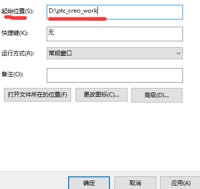

hi,it's easy, u need config file, and placed in the startup directory. aa.pngTIM图片20180120103255.png
 and, you'd better set some maykeys for this datum.
