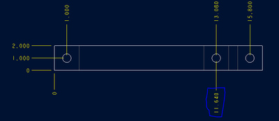

Hello! I'm looking for some help tracing down a really weird error; On a few of our template drawings, (drawings & models that we save-as from repeatedly), certain dimensions on the drawing don't update properly after the model is updated.
That is to say, we'll update the model and regenerate, then switch windows to the drawing and most of the dimensions will have already updated. However one or two will sometimes change to some garbage value, neither what the dimension was before nor what it should be now. A manual regenerate of the drawing will then update these wayward dimensions to the proper value. The problem is that most of the dimensions will update correctly leading the user to think the drawing is fully updated and ready to print without doing a regen of the drawing.

I've attached an example if you want to recreate the error. on first opening the drawing should look something like this:
Then switch over to the top level assembly and change the overall length. That can most easily be done by changing the parameters QTY or DIA in the relations. Then regenerate the model to update it.
Then switch back to the drawing. All changed dimensions on the drawing should update automatically, except the overall length dimension will have updated to a junk value:
Then regenerate the drawing, and the overall length dimension will update to the correct value:

Sometimes references require a double regeneration. Could this be your issue?
Hey Tom,
I guess so... Regenerating twice does seem to make the dimension update to the correct value. The confusing thing though is the vast majority of the dimensions all update properly after one regeneration. So it's relatively easy to miss one dimension. Especially because this only seems to occur on a small subset of our drawings.
What makes a dimension require a double regeneration? Especially when the model is already fully regenerated before even going to the drawing?

One interesting addition to the error, I just tried re-attaching the offending dimension to different geometry and it still wouldn't update along with all the other dimensions. This makes me think it has something to do with the dimension itself rather than the geometry it's attached to. Doing additional regenerations eventually makes the dimension take on the correct value... But again I'm trying to figure out why this particular draft dimension needs more regenerations.
