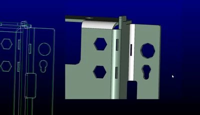

Hello!
I have a problem with the edges in shaded modus.
Circle is not round any more.
I have tested:
edge_display_quality very_high
edge tess quality
also the preferences  the shade quality
Nothing changes.
Dou you have some advices for me?
Thank you!

please upload your model.

It happen after unbending
www.pi-engineering.at
@PI_6131154 wrote:
Model
I do not see any problem.
Tip: rename your config.pro to config.pro_renamed and test model behaviour.

Looks fine to me too.
Settings that impact this:
StephenW
(To:TomU)
I have had massive creo performance issues with shade quality set to 10 (I currently have mine set to 3). I do not have issues with circles showing as segmented.
I see the "edge display quality" is where I get segmented circles but on both shaded and wireframe models.
I set the value as Martin recommended. Nothing.
But I thing, the part has something, because other parts are displayed ok.
Thank you!
