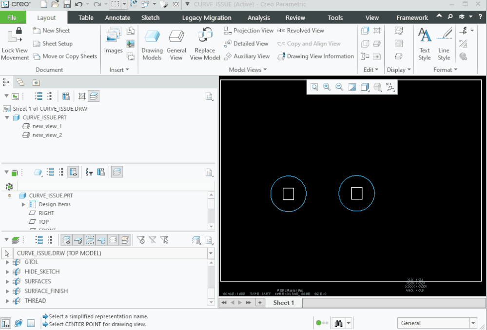

I just opened a ticket but this looks like a bug and I am wondering if any of you have encountered this and have a good work around. It looks like in Creo 9.0.7 its not respecting independent layer status. When I try and hide a curve in one view it effects the top drawing layer status even though it is not set as such.
We just made the jump and have found some other small issues but this is the biggest one for us.
Best answer by Chris3
fasthlr_drawing yes
was accidentally set. It was removed and the issue has been resolved.

It MIGHT be because you might have the curve on more than one layer.  I use "Rules-Based" layers to prevent that.
Chris321-Topaz IAuthor
January 10, 2024
That curve is only on one layer. I confirmed it with the feature information report.
Chris321-Topaz IAuthorAnswer
January 11, 2024
fasthlr_drawing yes
