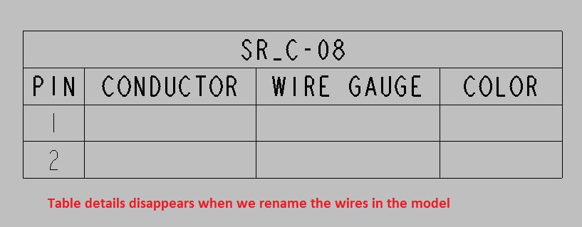

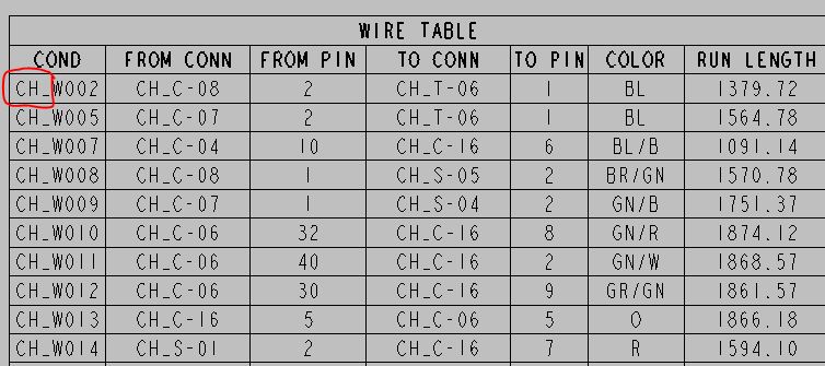

We are facing an issue with Wire Tables in Creo Cabling.
I have the wire 'from to table' in which all the wires/conductors are named starting with "CH_" and the wire is CH_W001.
But we want to remove the starting letters from the wire names and wire name should be "W001" only.
I tried to rename the wires in the harness assembly itself; but in that case the connector table data disappears.
I also tried to apply FILTERS ( " != CH_* ) from table repeat region; but the wire table contents disappears.

I tried to edit the spools as suggested. But, still facing the same issue.
After editing the spools, I had to rename the wires also as these are carrying the earlier names.
And then the issue repeats, table contents disappears.
Is there any filter which can resolve this.
Please suggest.
Nitin

May 4, 2016
The filter looks at each line and only displays those elements that do not start with CH_, Since all the visible entries start with "CH_" the filter removes all the visible entries.
You should be able to create a Repeat Region Parameter that equals the Wire name with the "CH_" trimmed off of it if you are just looking for the table to look like that.
Change the column header to rpt.rel.Repeat_region_parameter where Repeat_region_parameter is the name of the parameter you create in the Repeat Region Relations.
