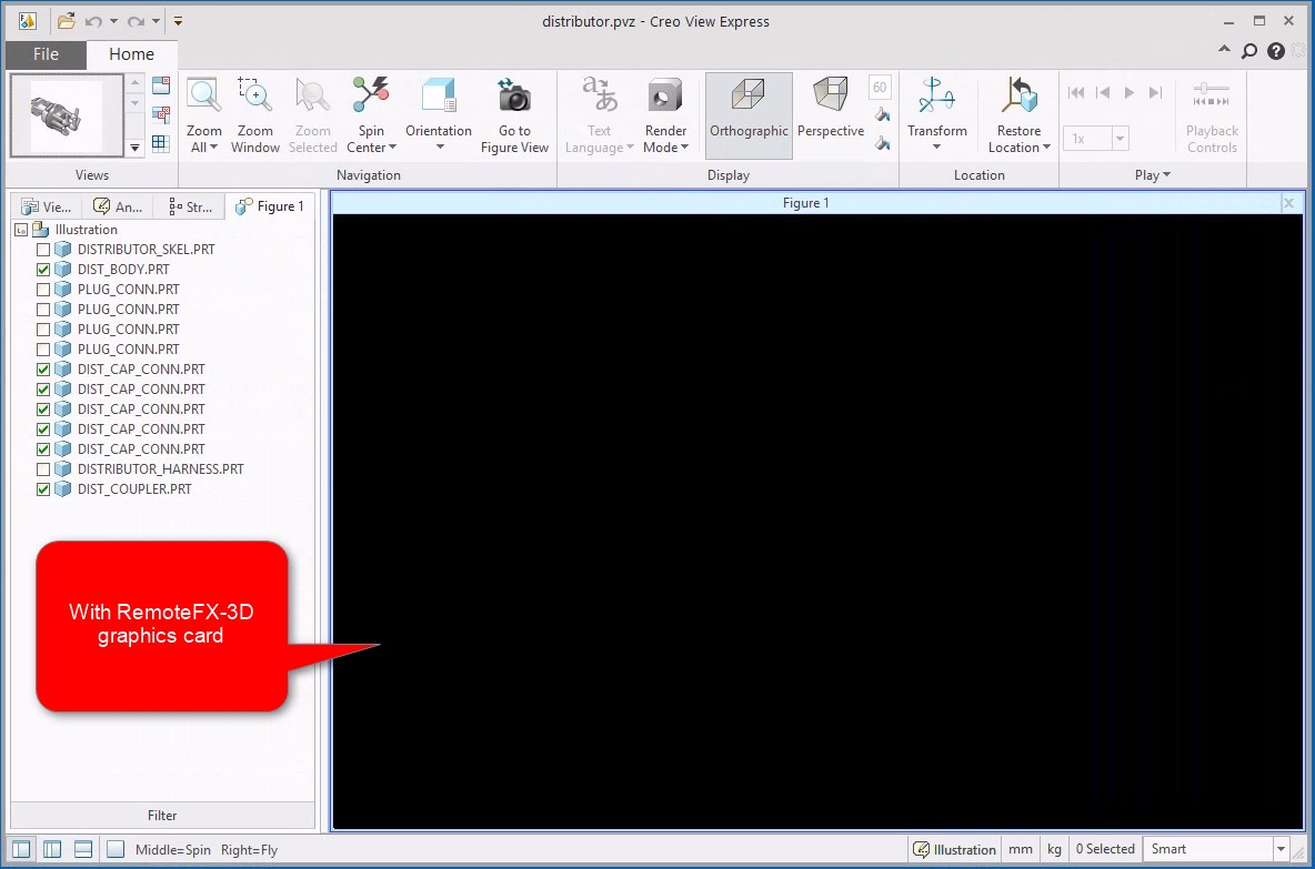

While Creo Parametric is working without any issues, Creo View (and Creo Illustrate) 4.0 F000 is not rendering anything and showing a black box instead (it's the distributor.pvz, which is one of the samples from the Arbortext Editor installation):

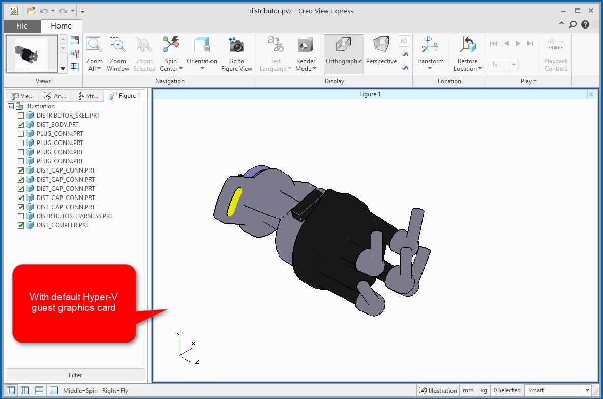

  When removing the RemoteFX graphics card from the VM, the guest will run with the default graphics driver (no OpenGL), we get the following result:
However, this is rendered with a very poor performance and the rendering itself doesn't look as smooth as with a "real" computer.
Ironically, I get at least s.th. displayed withouth the RemoteFX-3D adapter, although this is intended for those scenarios.
