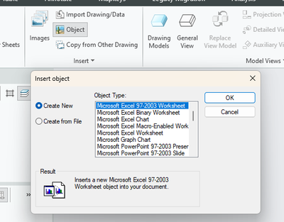

When exporting a 2D creo drawing to PDF, the microsoft word objects that are inserted are not selectable text in the final PDF.  Is there a setting so that inserted objects are selectable/highlightable in the resulting PDF?
Inserting an object in this way, but it seems to come into the 2D drawing as an image and not text/table.

The objects thus inserted come in as an OLE object. Meaning they remain as a Native file (Word, Excel etc). For Notes one may keep Standard Notes for Drawing in a Text file and ask Creo to read from the file or copy--> Paste those texts. Drawings converted to PDF using above would have 'Selectable Text'.
For Spreadsheets.... Create a Creo Table.

So there is no way to save a 2D drawing to PDF where OLE objects are selectable objects?  Or there is no setting in Creo that makes OLE objects selectable text before saving?
Check out these settings.
Setting NameDescriptionValueDefault Value
intf2d_out_acad_mtextCreate a single MTEXT entity for multi-line text notes when is set to YES.yes, noyes
intf2d_out_acad_norm_lead_blockYes - Multiple normal leader annotations are exported to DWG and DXF file formats as blocks. No - Multiple normal leader annotations are exported to DWG and DXF file formats as separate entities.yes, noyes
intf2d_out_acad_ole_as_imageControls OLE export to DXF/DWG. Yes - exports OLE objects as DXF/DWG IMAGEs. No - exports OLE objects as separate entities.yes, noyes
intf2d_out_acad_splinesControls whether splines are converted to corresponding DXF/DWG entities or exported as polylines.as_spline, as_polylineas_spline
intf2d_out_acad_sym_block_nameDetermines whether symbol definition or symbols instance names are used as block names in DXF/DWG export when symbols are mapped to blocks. SYM_DEF - symbol definition names are used, SYM_INST - symbol instance names are used.sym_def, sym_instsym_def
intf2d_out_acad_text_alignAs_is - Exports notes to DXF/DWG with their original alignment values. Fit - Exports notes with FIT alignment.as_is, fitas_is

I only had time to try a couple of those suggested settings.  I thought "intf2d_out_acad_ole_as_image" would be the one for sure but it hasnt worked yet.  I will try the remaining suggestions on your list and let you know.
