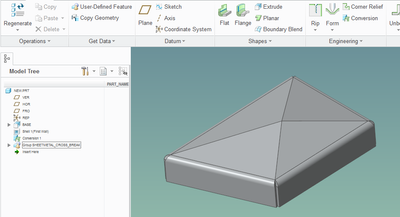

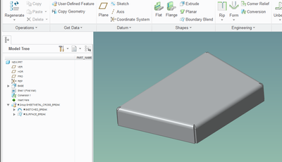

Although it's not part of the core functionality, you can "easily" make a UDF (user-defined-feature) that makes such repetitive tasks a snap.  For-example, this UDF creates a sketch showing the cross-diagonals and also a pyramid like surface on top of a 4-sided face defined by the bottom and top edges.  So you select the bottom edge, the surface on which to place the sketch and the top edge and voila:before_crossbreak.png
 to use: unzip the attached file; then use the User Defined Feature function in the Model tab / Get Data group, then select the sheetmetal_cross_break file from wherever you extracted the zip file contents.   Follow the prompts, it's pretty straightforward.  Note: UDF was built in Creo 3.0.
