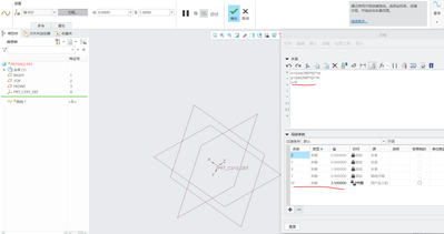

Curve from equation failing.
when parameter “m” is not integer, the curve is failed to regenerate.

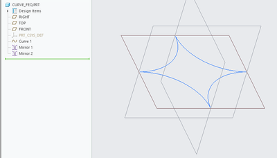

in Creo 10.0.3.0 your curve is created for odd values of M parameter, only.
My suggestion: Create one quarter (set range 0 to 0.25), only -AND- then use Mirror feature to get requested result.
