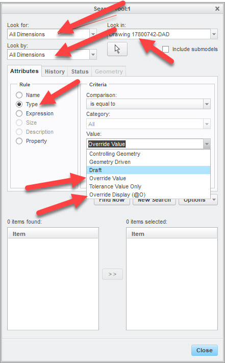

Hello everyone!
Is there any command, macro or add-on that would allow a checker to easily see if a drawing has any edited or overwritten dimensions in Creo 3.0?
Best answer by StephenW
Modelcheck is the best way for find overwritten dimensions but it's not something a user can just run. It needs setup.
You can use find on a drawing for override values and override display.
StephenW23-Emerald IIIAnswer
June 5, 2018
22-Sapphire I
June 5, 2018
For ModelCHECK set DIM_OVERWRITE as E in respective check file to report overwrite dimensions.
