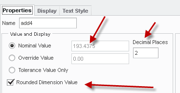

All,
In CREO 3.0 M020...
I have a part in a drawing. I rounded down the decimals in the drawing. When I return to the model, the dimensions are rounded down per attachment "dim1" in red. In attachment "dim2", I click the dimension and it shows it's unrounded value. First of all.....the dimensions are in red. If I regenerate, they remain red. I guess I am used to the round off forcing the dimensions to be finalized per attachment "dim 1" after a regenerate in say WF5, the last release I worked in. What's the deal? Have I changed them or not? I like the idea of a show dimensions that are allowed to be shown 2 place on the drawing but remain it's logical 3-4 place in the model I think. However I imagine it would get into "what is your true tolerance intent?" Confused. Maybe it's too early still?

Color schemes can be different but I suspect the red dimension are "locked" sketcher dimensions. 'Locked' as in they can't be changed by dragging.
Rounding, well, my suggestion is to look at the properties in the drawing and see if the rounding box is checked.
PTC definitely changed the settings so rounding became default at one point. There are config options to control this

Yeah ...looks like the check box for rounding does impact the outcome. I kinda like this. I think? So dimensions are show and I can control the places on the drawing....and the model remains as it was. However - I am getting the red dimensions. I went into the model and selected them all - then unlocked - then regenerated. There does not seem to be a consequence in doing this? They are now blue. I'll have to see how this plays out. Thanks for the suggestions Stephen!

You can uncheck the box and it will round. Then your stuck with .1875 being .19 for example. You'd have to manually re-establish it at .1875.
One thing I did not check....if it changes the model while doing it in the drawing. This does make it a good thing if someone is detailing the drawing, and the model is locked. Seems like a win win?

Yes, it definitely changes the model on a shown dimension. So if you wanted your model to be .1875 and you change the drawing to 2 places (not rounded), your model is now .19.
For a locked model (not locked dimension), you wouldn't be able to change the .1875 shown dimension on the drawing. The shown dimension belongs to the model which is locked.
I like having rounding options, I just want to make sure I understand exactly what is happening and what is default AND that it doesn't change from release to release.

If you check the box in the drawing (which it is by default - or by config?) then it won't change .1875 to .19. It will lock the dimensions. You can unlock them and all is the same. So the drawing seems like it can do "show dimensions" as long as box is checked. When you save the drawing it will also save the model. However - the model decimal places stay intact.

Config option round_displayed_dim_values by default is YES (for newly created dimension) so the box is automatically checked.
Correct, you can change the decimal places on a dimension and it won't physically change the model dimension.
