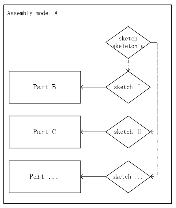

Here is my case,
Assmbly model "mode A" public features: Ⅰ、Ⅱ、Ⅲ ...
And B use copy geometry  fucntion get the feature  Ⅰ;
And C use copy geometry  fucntion get the feature  Ⅱ;
etc.

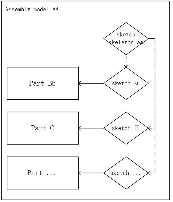

Its worked well, but when new project coming,
The only difference is we need change the featureⅠ to  feature α, others need to keep same.
But when I try to save as the "mode A " to "mode AA",
Neither core or Windchill alllowed me to re-use model C or others.
They force me to make new parts at all.

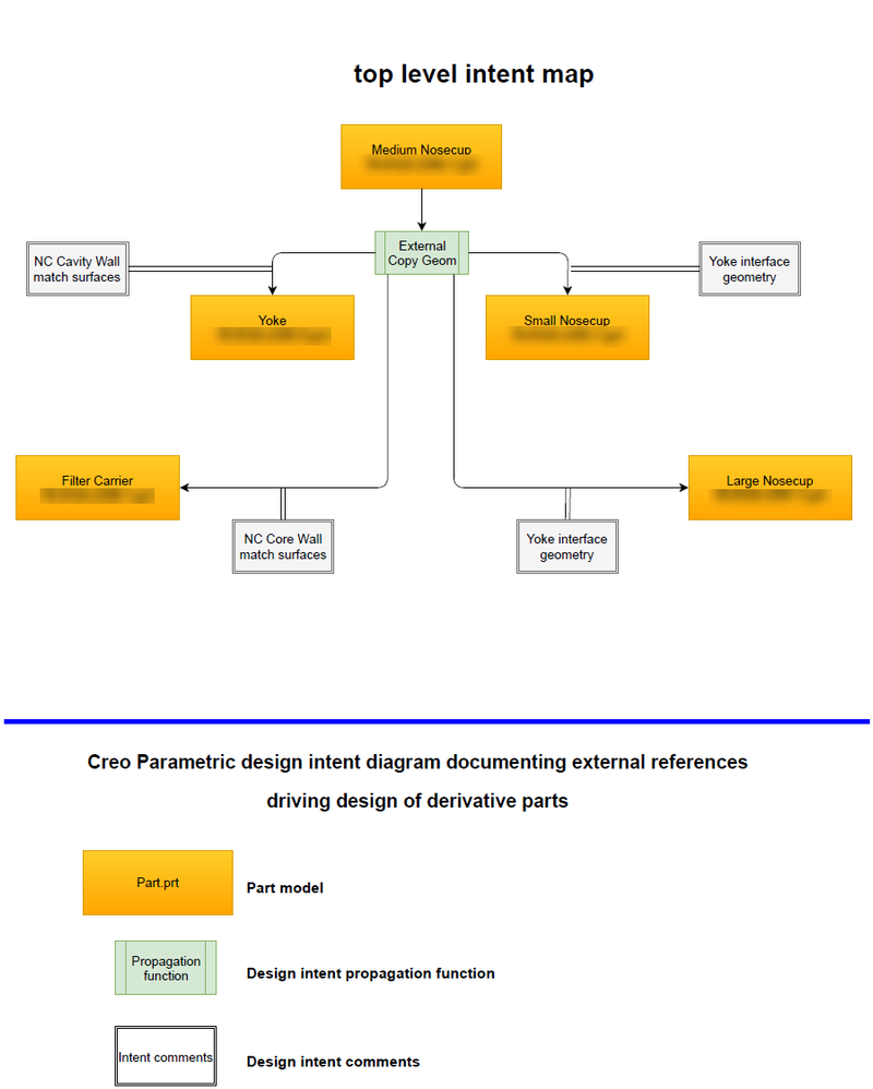

Here is an example of how to represent top down design planning graphically which is very helpful in planning how to actually set the models up in Creo. This map shows a master model driving the design of 4 children using copy geom functionality. If you can sketch a map like this that explains what you need then it it easier for others to understand what you are trying to do.

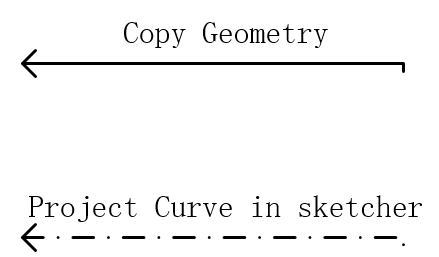

Sorry for my bad English, I try to make diagrams, hope can with some helps,
I want make a product model A, then if I have new project  i will make a new one AA,
The difference between A and AA is very little normally in my projects.

You state above: "I want make a product model A, then if I have new project  i will make a new one AA, The difference between A and AA is very little normally in my projects."
Are you trying to use a single assembly A that you can alter by swapping out  component B for Bb?
In your diagram A and AA are assemblies comprised of parts. So you should be able to save a copy of assembly A renamed to AA and then swap out components within the assembly. This is easily done and you can use interchange assembly functionality to do that. This would be independent of the use of Copy Geometry or other top down design functionality. You can swap part B with Bb in the assembly.

Hi, you can try this way.
1. Make a common file (sketch skeleton) that includes both the features of "A" and "AA"
    ie just add sketch "a" to A. The file A will then contain all the sketches α, I, II & III.
2. Use publish Geometry to gather different reference groups
3. For each part (B, Bb, , C &...) , copy geometry from the respective PG.
Hope this helps

Thank you,
it is working,
I add one more sketh in the part to accept the features(not directly use for 3D features),
Now I just thinking how to manage the  common files (sketch skeleton).
I use windchill system, our windchill Plug-in in creo doesnt allow to upload or open sketch file.
