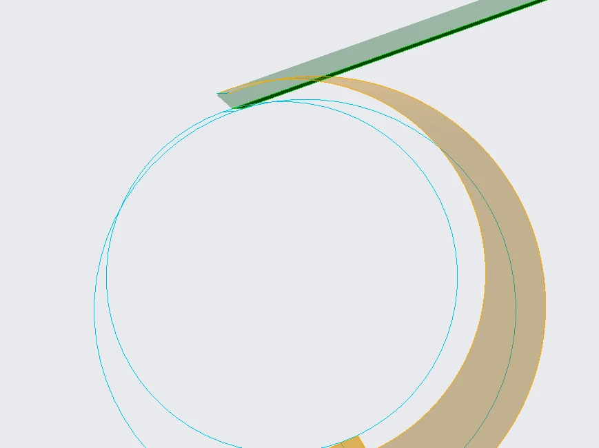

1. make a cone
2. sketched rip and chamfer
3. failed bend back
As a result, I want to bend the chamfered sheet metal to make a cone. Is there any other way other than this?

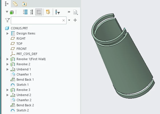

I added two cylinders to your model (diameter=916 and diameter=1100) ... see following picture.
For both cylinders I did following steps:

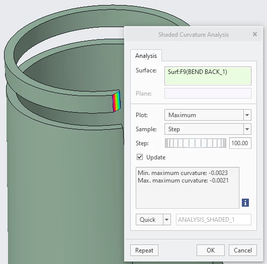

Finding no.1
When chamfer surface is bent back then it changes from planar surface to curved surface.
This is why you cannot bend a bent cone back - Creo does not know how to deform chamfer surface.

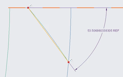

Finding no.2
If you create sketch going through chamfer edge after bend back operation, you will get your angle.
At the top (diameter=916) it is 53.5 degrees.
At the bottom (diameter=1100) it is 52.9 degrees
So you know that the angle varies between two above values. >>> and this is the answer you are looking for (I hope).

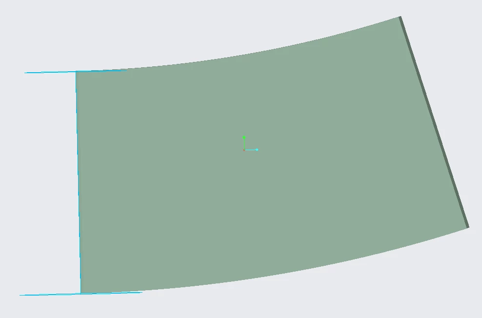

- sketch1's diameter is 1100, sketch2's diameter is 916, height is 2000, then I was blended.
- then I creat DTM3 to rip
I am sorry I am not able to give you any advice. I can only confirm that chamfer created after unbend will make it impossible to bend geometry back.
The question remains why you want to use the given procedure.
When we bend metal sheets in factory, we cut metal sheet before bending. so I want to know the angle change that occurs when bend with chamfering. If you know other procedure to solve this question, you can ignore my procedure.
For exaple, when champered 30degree metal sheet bended, angle changed lager or smaller like 27degree or 33degree.
please attach a picture explaining the difference.
Note: In your previously published picture chamfers did not consume end faces of unbent sheet, therefore the sheet size with/without chamfers is the same.

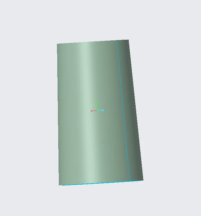

Yes that's what I wanted, but if this is chamfered inside the cone, it seems that bend back is impossible.
Could this problem be solved?
I opened model shown in my reply from 2023-02-24 02:37 PM, changed outer chamfers to inner ones and redefined Sketch features. Model was regenerated successfully. NO PROBLEM.

After a bit of experimentation, with a cone, it appears creo is unable to bend back a cone if you modify the end of the driving surface.
cone's thickness was 50
The bend back feature needs the original anchor surface, or at least a portion of it, to work.
