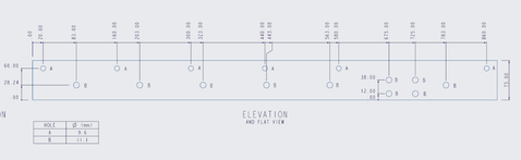

Hi all,
I was wondering if it is possible to create a hole table containing only the diameters and corresponding labels?
I looked online but the only mention of something similar was this post (https://community.ptc.com/t5/3D-Part-Assembly-Design/Custom-hole-table-to-auto-output-custom-data/td-p/536880) from 2018 which didn't conclude with an answer.
I am looking to create the same type of table (Lettered holes referring only to the diameter, as our punching department prefer the dimensions to be visible on the drawing itself- but having a diameter call-out  on every hole makes our drawings very messy) and ended up doing it manually as I couldn't find a solution. The below image is what I was hoping to achieve automatically with a hole table. Manually checking and entering all of the dimensions is very time consuming, especially on our more complex parts.
I did consider a repeat region in a regular table based on the suggestions in the other post I linked, but I don't have any experience in using them, and couldn't work out if it's even possible to get hole dimensions, let alone automate placing text by every hole, so I would still have to manually check and place the correct letter reference.
Ideally this would be an option in the hole table dialogue box (I can currently create a table with labelling and dimensions, but it lists this for every individual hole -A1, A2, A3, despite there only being two hole sizes) but from what I've seen I doubt PTC allow this functionality natively, but the ability to remove repeats, or base the labelling on the diameter column, rather than per hole would be amazing.
Any help would be appreciated. Thanks!

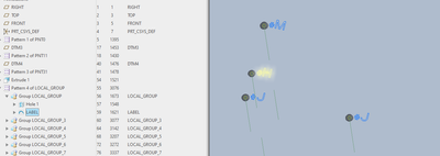

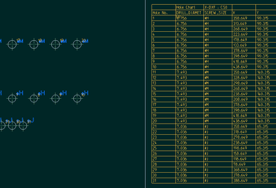

I think you can hack many things with out-of-the-box Creo but maybe that's not a good approach.
However, using a UDF hole where each hole feature is actually a group of a hole and a small sketch that provides a label might be an approach you can explore:
(the label text is based on it's holes parameter, so it can be made quite parametric)
This maybe takes care of labelling the holes on the drawing, it still remains painful to automatically dimension them and to make the "summary" table on your drawing, but that last step seems you can do pretty by copying the generated hole table chart:
