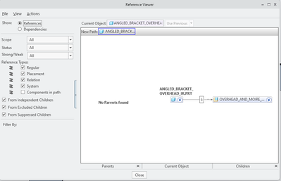

I am working with Creo Parametric 10.0. I saved a part using Save As->Save a Copy in the same working directory and started editing the duplicated part. But I noticed that all those changed also got transferred to the original part. How can I prevent the editing of the original part in this case? Thanks.

Can you post the models? If not, post some screenshots of the model tree and the global reference viewer showing parents of the parts in question.

Attached are the images of the model tree and reference viewer.

With the sketches being external to your extrudes instead of internal, Could it be using the same sketches?
