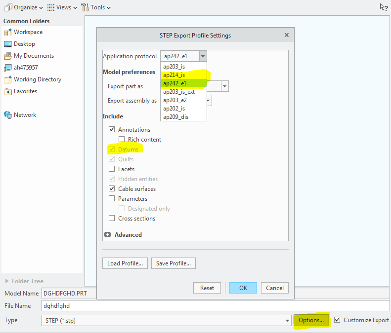

Hi Folks,
I've got an assembly that I need to export to a .stp file. There are several Datum points and Coordinate systems on the assembly that must be included in the .stp file. However, irregardless of what export settings I use, the Datums and Csys are not exported to the .stp file.
Has anyone else run up against this problem?
I've been search online for hours for a solution but I have nothing.
Best answer by Chris3
Change the export option to AP214_is or AP242 and make sure that the datum checkbox is checked.
Chris321-Topaz IAnswer
August 22, 2018
Mr_Scraps1-VisitorAuthor
August 22, 2018
Thanks Chris,
That worked like a charm!
