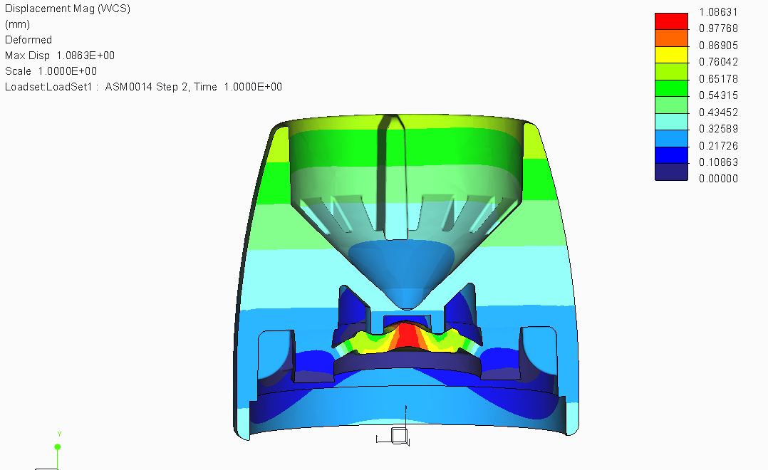

Hello everyone,
I am new to Creo simulation and met some problems as below:
1. I wanna see how much deflection of rubber disk could be if providing 10 bar on the surface of inner ring. Rubber disk is equipped in the plastic device ( showed in the picture), so when it moves up, it will be blocked by the contact surface with the device( marked as the red circle), which means I need define the constrait on the contact surface, but I dont know how to do that. The top and bottom of outer ring are placed on the plastic part , so I give a constraint on them as well.
2. The rubber disk and plastic device as an assembly part, I am not sure if it is ok to do FEM on an assembly part.
3. The deformation of rubber disk compares to the dimension of rubber disk is small, so I considered it as linear situation, is that ok?
If anyone can help with these problems, I would appreciate that:)

Do you need to know what happens if the rubber disk contacts the plastic part?
Or do you only need to know whether it will contact?
If the latter, I think you can analyse just the rubber disk. I would use mirror symmetry in two directions to reduce the model size (and to help constrain it!), and then constrain the top surface only in the direction of the pressure.
I assume you know what the starting clearance is to the contact surface; you can therefore look at the maximum displacement value to decide whether the disk will contact under 10 bar.

I tried again, as you said, first created cuts in the assembly by solidifying the plane, then constrained the bottom of outer ring of the rubber disk without displacement, providng 10 bars at the bottom surface of inner ring of rubber disk, defined the contact interface between the surface of inner ring and the conact surface of top of VTC. Simulation works, the result is showed as below, do you think all these processes are right? anything I missed?
  1. Why does your screenshot say "Time 1.0"? Have you run a linear static analysis, or something else?
  2. What deformation factor are your results displayed at? It looks like there is some interference between the two parts - it's possible you need to define more contact pairs*.
  3. What quantity is shown by the colour scale - displacement, or stress, or something else? What are the units? (I prefer not to show smoothed colours - they look nice, but I think the information is clearer with 'hard' contours.)
*If you are creating contact interfaces manually, you need to select every pair of surfaces that could contact. For example, if one part has surfaces A and B, and the other has X and Y, you may need to create:
A with X
A with Y
B with X
B with Y.
1. Time 1.0 is from the result window definition, I think that is set automatically. There are two steps, one is step 1 , time is 0s, and the other one is step 2, time is 1.0s. I ran a nonlinear analysis.
2. The doformation scale is 1. I defined 4 pairs of contace interface. surface 1 and 5, 2 and 5, 3 and 5, 4 and 5.
3.The simulation shows the displacement of rubber disk, unit is mm.
Is there still sth wrong?
It looks better in your latest results screenshot.
In the previous one, it looked as though the rubber disk was passing through surface 3, but I think you've fixed that now.

I am not sure if it comply with the design of your assembly, but I would have added a pressure load on the entire bottom surface of the disc and also constrained displacement of the top of the outer ring.
Did you choose "Calculate large deformations" in the nonlinear options?

I tried the automatic detection of contact. It showed around 20 contact surfaces, and most of them seem no relevant. So I just chose 4 contact surfaces showed as above.
I defined a new material as silicon rubber and used it to the model.
