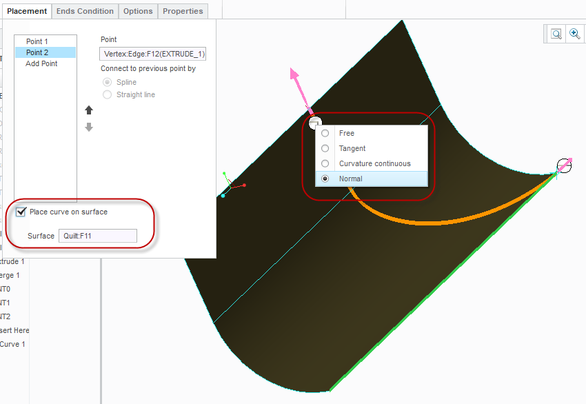

  • Curves
    • Through Points, Offset Csys, From Xsec
    • Define ends conditions (Tangency, Curvature Continuity).

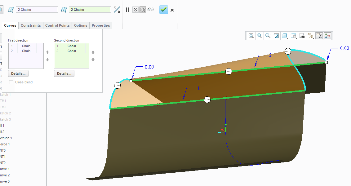

  • Boundary Blend
    • Similar to Blends, transitions between curves.
    • First and second direction options.

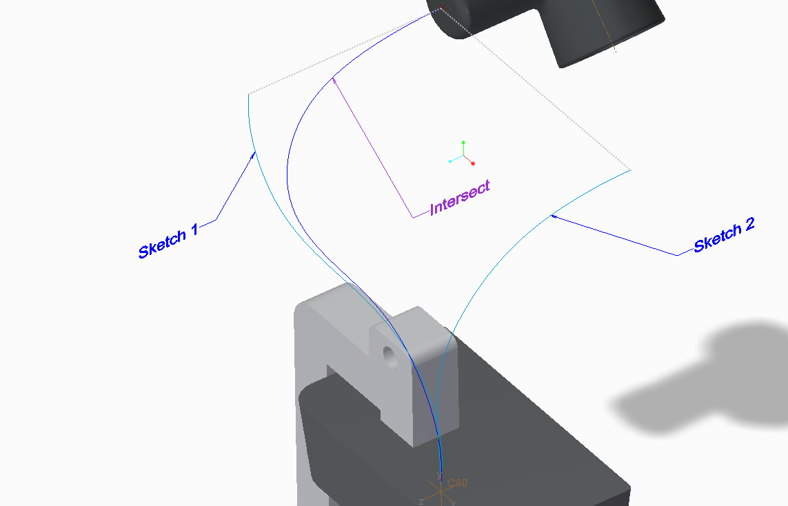

  • Intersect
    • Creates a new 3D curve from two 2D sketches/curves
    • Creates curve at intersection of surface/surface or surface/datum.

Curves
Boundary Blend
Intersect
