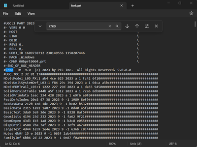

Open the file in notepad and you should be able to see the creo version they were made on.
https://www.ptc.com/en/support/article/CS328109
Here is an example of what I found using this. (I opened notepad and went to the files save location, changed notepad filter to all files and then selected "fork.prt" for this example.) You can see 9.0 which is the version of creo I am running and this file was saved on.
This article also mentions this method.
https://www.ptc.com/en/support/article/CS358480

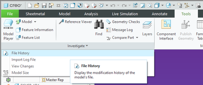

You can also look into the file history to see who and when it was saved since creation.  (Unless someone removed the history when doing a save as.)  You could then query them as to the version used.
When I look into the file history the version field is blank. Does this mean it was erased by a save as? I also can no longer contact the person who made the file, so what should I do?
