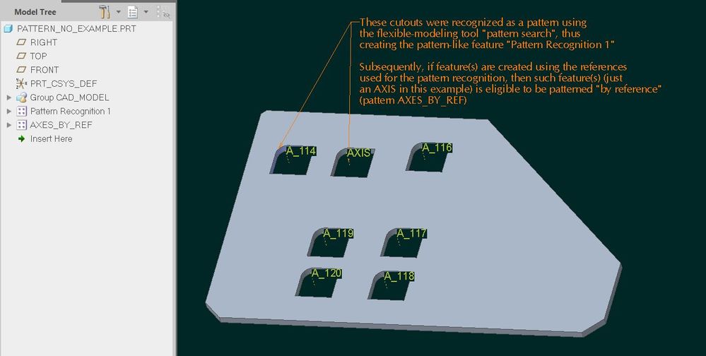

Sounds like what you are doing should work, though I am not actually clear how you are defining your axis.
It has to be related to the features that were used to drive the pattern recognition feature.
I tried it in Creo 4:
I think one has to be careful with references. I also notice this pattern recognition does not 'auto-update' - so if you insert more holes, you will have to edit-definition of the pattern recognition feature in order to "refresh" the pattern references.

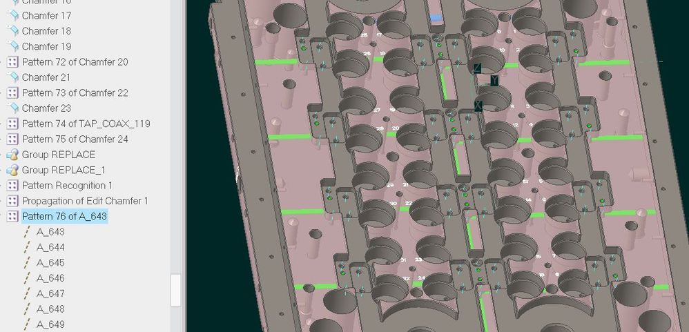

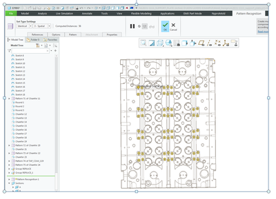

So when I run pattern recognition, It finds 56 instances. Great!
I accept that, and then add an axis to the hole i used for pattern recognition.
when I pattern that axis, I get only 2 axis created.
I also tried it in creo 3, and get the same result. So maybe its the way the holes were originally created. (I believe they were put in by solidifying a copy. )
In my limited experience, I've had issues with this tool: the new pattern put all the new axes on top of one another - but you are only getting 2 - so you aren't really getting the "pattern by ref" action (which should give you 56 instances). So is your pattern 76 actually a pattern by-reference? Can you post your model?

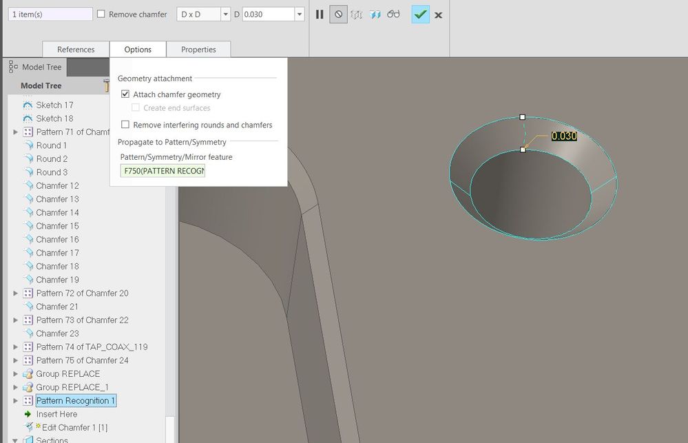

I found one work-around: the tool still works for propagating the "flexible" adjustments such as edit chamfer to all the recognized pattern members (via the flex-edit feature's options menu):

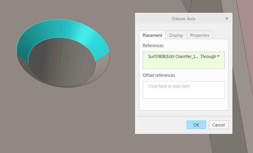

So you can "non-modify" an edge (leave it at the original value) and then attach an axis to the "modified" surface:
Then pattern the new axis and you'll get 56 of them:
This "works", because the ref. pattern that will be used will be the one that propagated the non-change. But the surface IDs of all those chamfers probably changed and the model became more complicated.

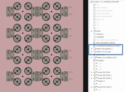

Instead of stepping out the part, you could try collapsing the 4 solidify features into an independent geometry using the collapse command. I tried this and afterwards I was able to make the pattern of axis the way that you want. Might be a bit cleaner too as the solidify features are currently referencing the drill or whatever that is that made the holes.
