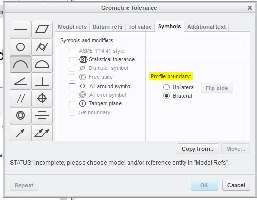

The default for Surface or Edge profile tolerance is Unilateral currently on Creo. Usually we need it as bilateral and it is a bit annoying that it is necessary to change it every time.
I tried to contact PTC if there would be any config.pro or DTL setting to change it so that bilateral would be default but their reply is that it is not possible (Document CS253724 - https://support.ptc.com/appserver/cs/view/solution.jsp?n=CS253724&source=Case%20Viewer). They suggested to create a mapkey but I don't think that is a proper solution to implement.
I hope this is frustrating for other users as well, so please vote UP for PTC to change the default to BILATERAL or to create a setting that would do that.
