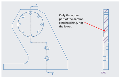

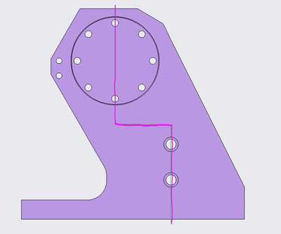

Hi I'm trying to create an offset section (See the pic attached). While showing the section on drawing, I'm not getting the hatch properly.

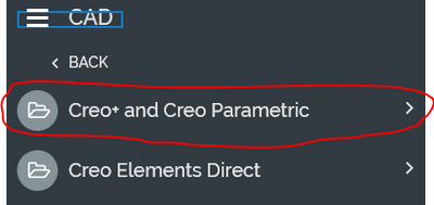

You are in the wrong forum.
PTC has two CAD systems:    Creo+ and Creo Parametric    and     Creo Elements Direct.
Which makes it confusing.
More, for Creo Elements Direct:
- The 3D software name is Modeling, and
- The 2D software name is Drafting.
For Creo+ and Creo Parametric, use only this tab:
You should move your post to this community to have a better chance to get an answer.

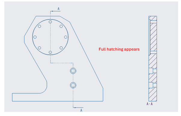

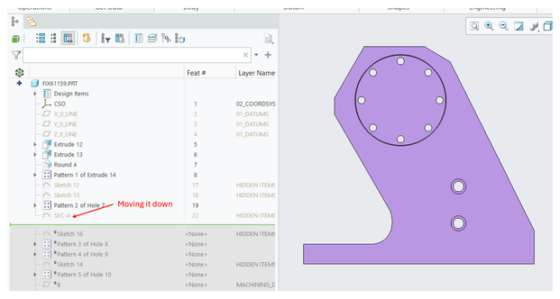

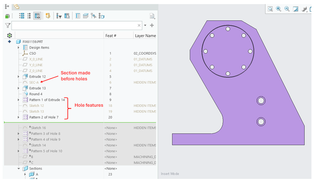

I tried recreating a similar section in another simple model, just to check if the issue is with Creo settings or something. But it worked there.
Strange! I don't know what's wrong in the model, but I found an interim solution:
It works when I create the section before hole featues.
